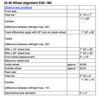

        Cool, thank. Are the numbers I found on the build journals website accurate for stock alignment?

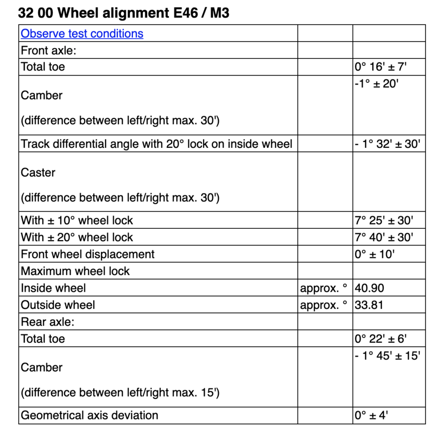

          It is somewhat correct. Here is the factory alignment -
Name:	Screen Shot 2021-07-30 at 7.28.20 PM.png
