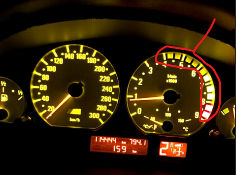

    Hello,
    A question about the instrument cluster.
    What do the shiftlights monitor? Water, oil engine temperature?
    Which sensors give the signal for the lamps? someone has information...

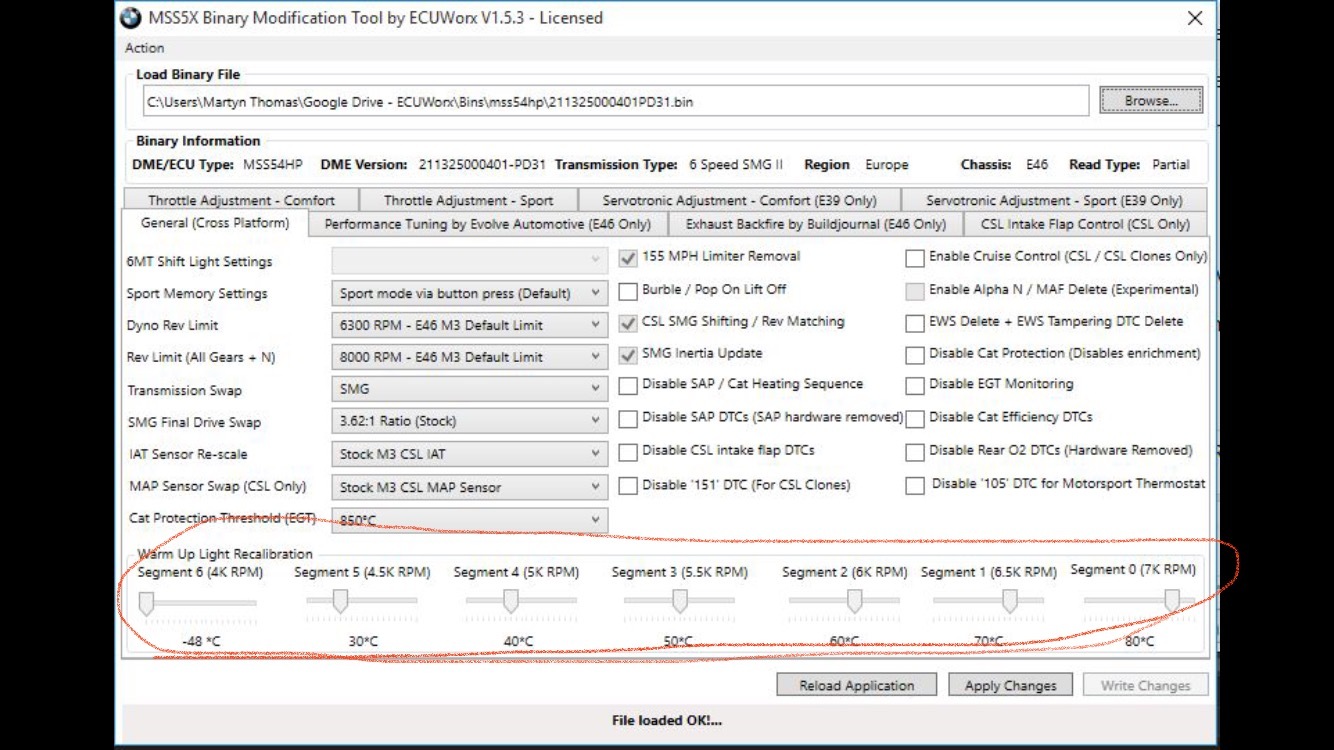

    I'm pretty sure it's oil temp because in ECUWorx MSS54 Binary Tool(phenomenal tool) you can modify where the lights come on and off based on oil temperature.
      Actually I believe that by default it's coolant temp, but it can be modified to oil temp?
        I would have guessed coolant now.
        ECUWorx MSS54 Binary Tool very interesting, could you adjust the display so that it ends at 90 °?
          Yep, I just did this over the weekend
            +1 ^ that's what I'll be doing basically.

                I’ve been running the csl values on all 3 cars for years. They are pretty much spot on what my intuition feels is right, anyway.
                  how does it work?
                  The lights turn off from left to right as the oil temp reaches the corresponding temperature.
                    Are the CSL values what are in that image above you?
                      that is clear. How do I get the values set
                        No, those are my own values on what I felt was right for me. I was unaware that the CSL had a different warmup light setting.
                          Ah, you have to alter the tune in your DME. Using the application beefaroni mentioned is probably the easiest method.
