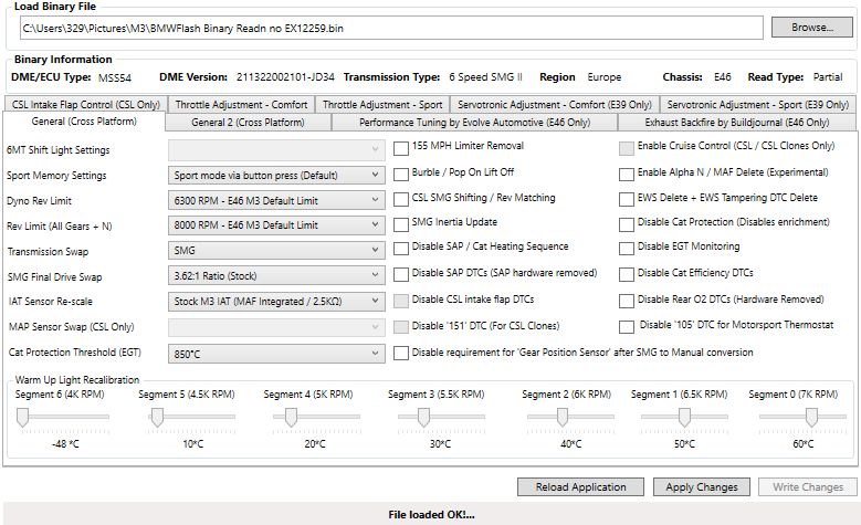

Name:	M3 Daten.png
        That's mine :-)
        do I have to buy a license or does it work that way? I read my data with BMWFlasch.
        Excuse the double postes and my many questions. I have no idea I'm more of a mechanic

          Seems like the temps are always oil temps, you don't have to change anything to have it run from oil temps in the first place?
            Yes, always based on oil temps.

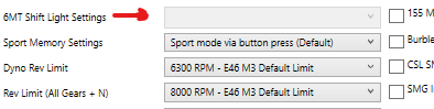

              I have another question. I have an SMG and it doesn't do shift ligts. Can you activate this with the tool?
              I can't answer why my car doesn't have one. I suspect that it was so delivered. The car is an Italian
                  Yes. I believe it says the option is for 6MT but clicking should also activate it for you. To flash your car you have to buy the license. I believe you can use the tool before but in order to write anything you have to pay the $25. It's really a steal for what you get.
                              Thank you, 6MT is not offered to me in the software, since it recognizes that it is an SMG and probably assumes that it is not relevant? Is there a way to do that?
                                That must either been changed or I always had the shift lights. Honestly they were pretty useless to me as my power curve went to 8100. It was more of a distraction when trying to actually go fast. Still is a cool feature.
                                Dig around Terra's posts on tuning for the hex if you want to go that route and modify it that way.
