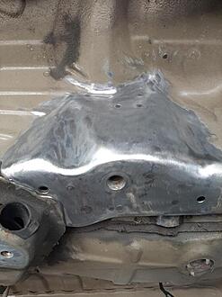

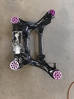

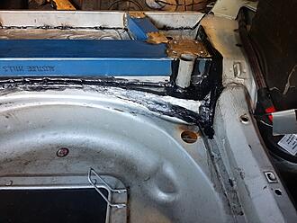

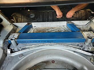

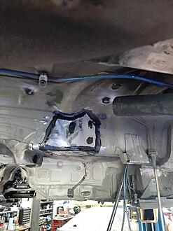

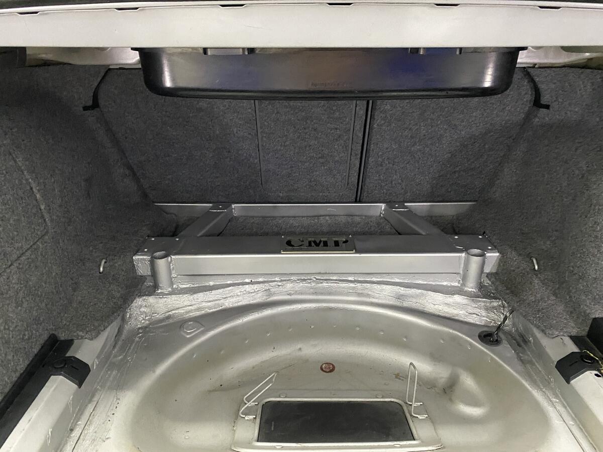

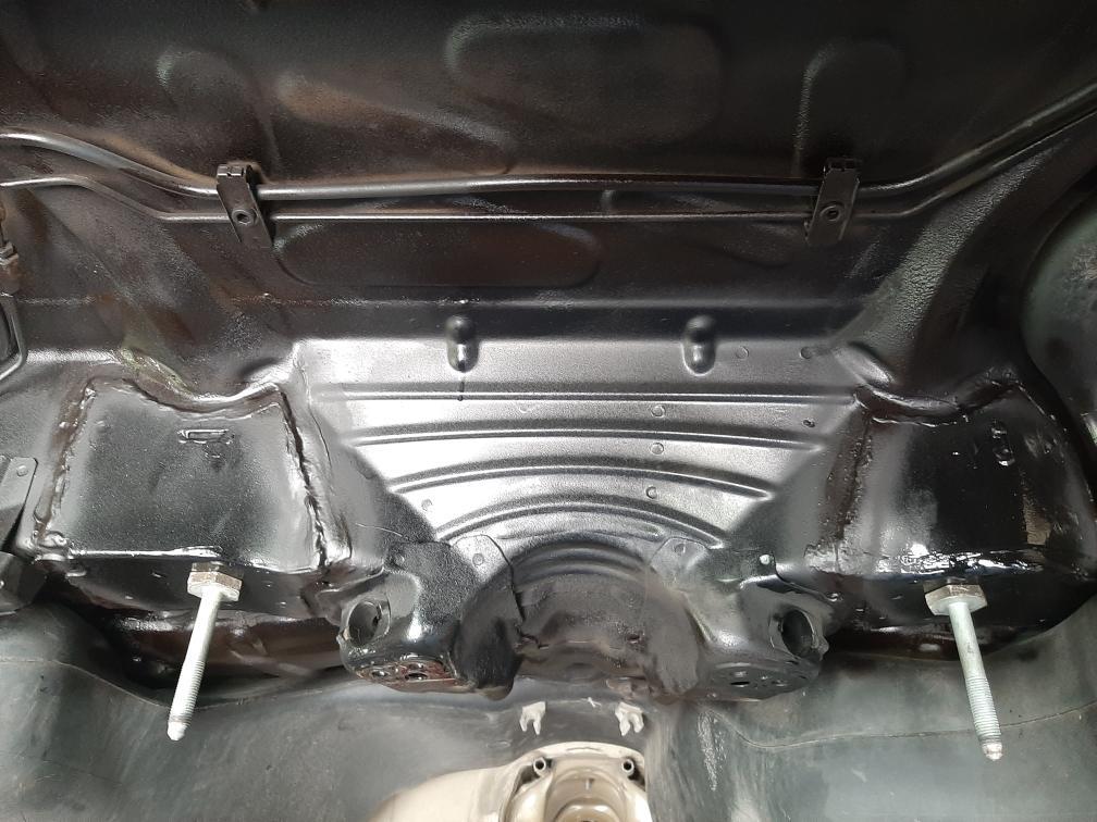

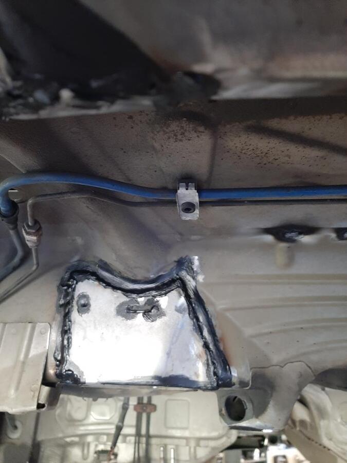

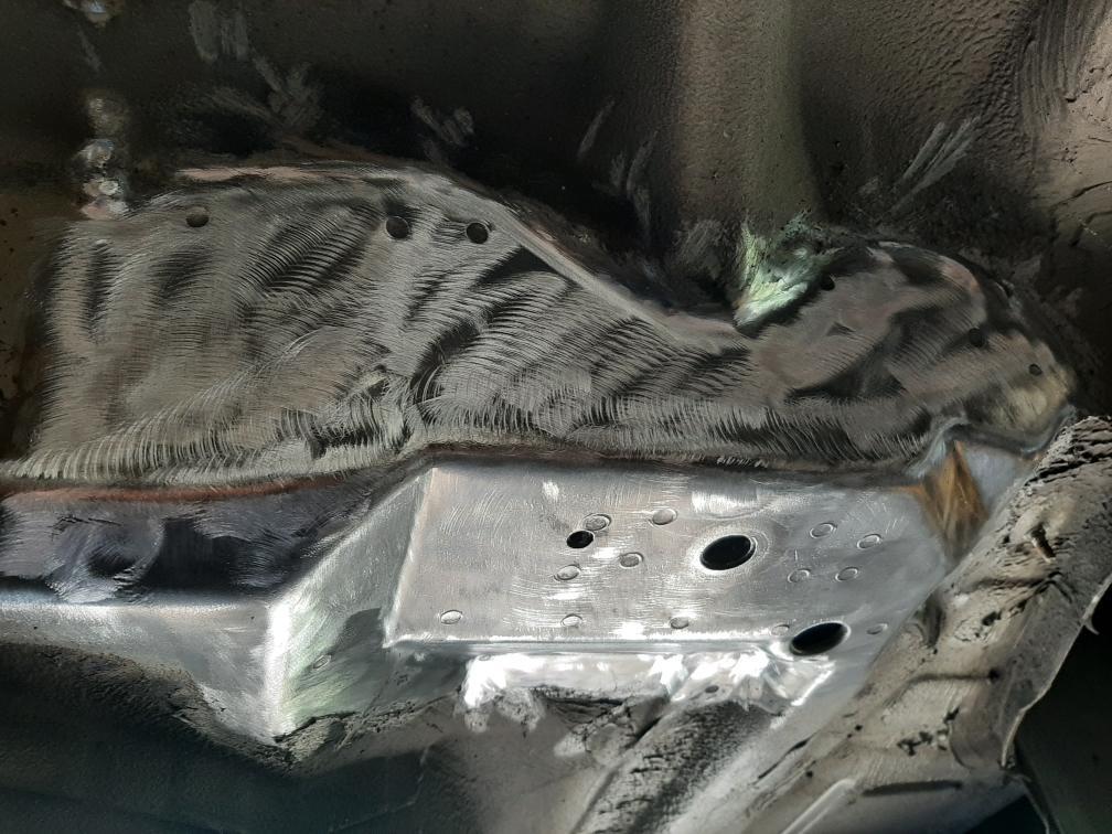

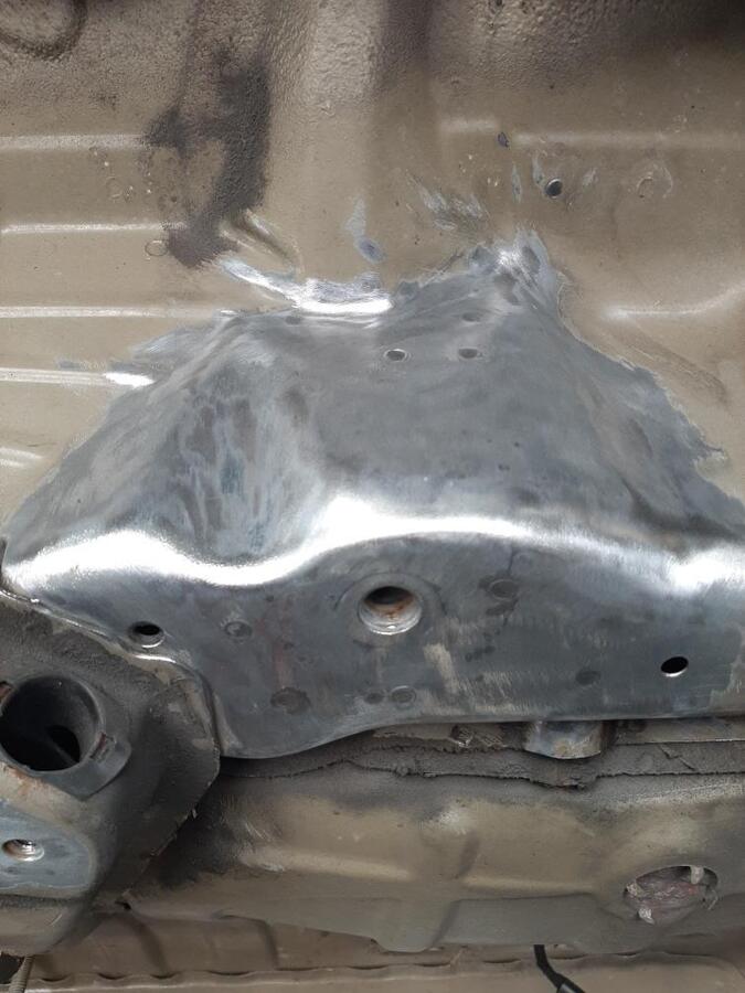

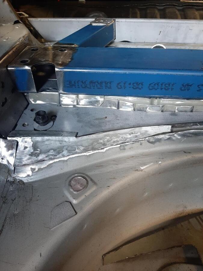

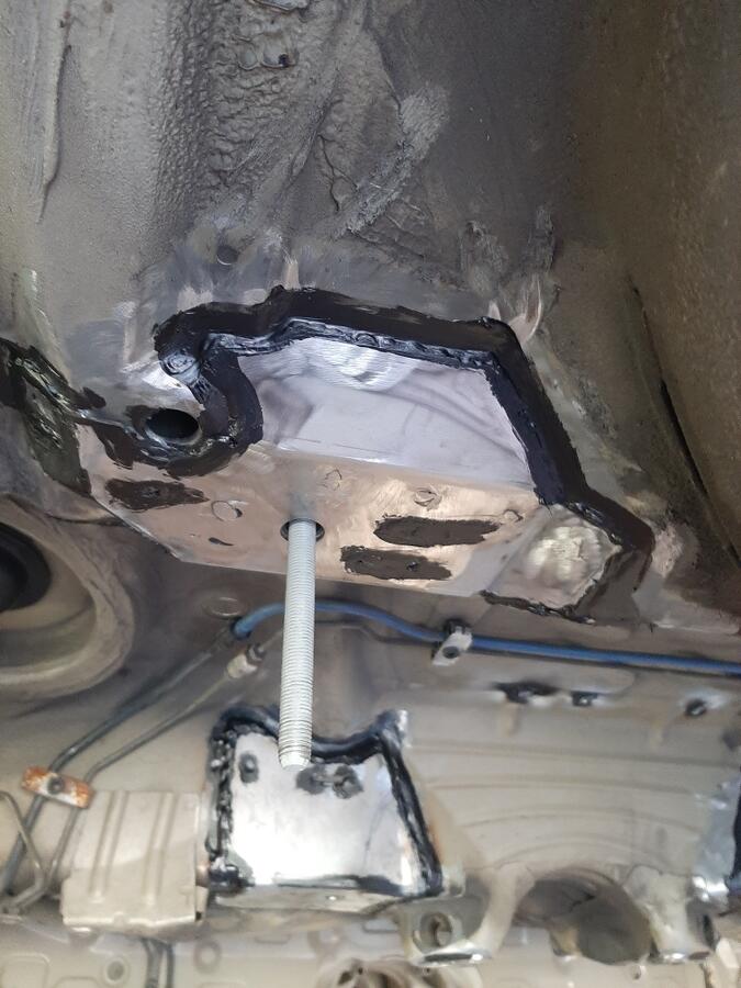

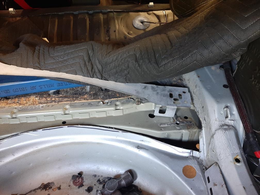

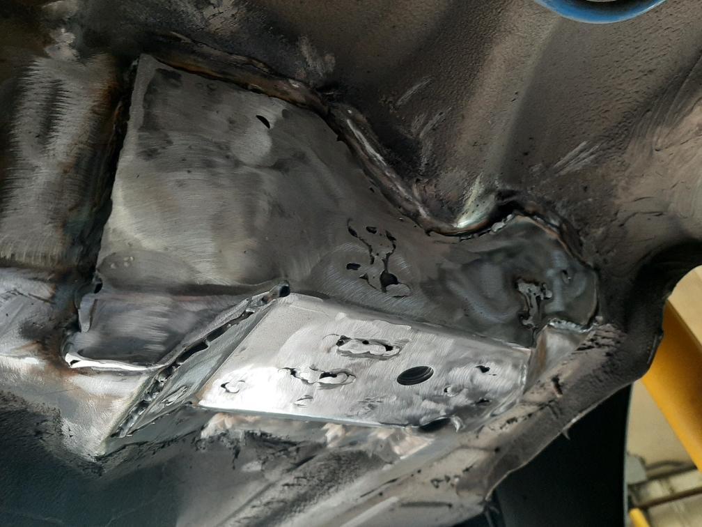

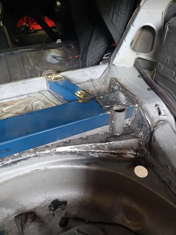

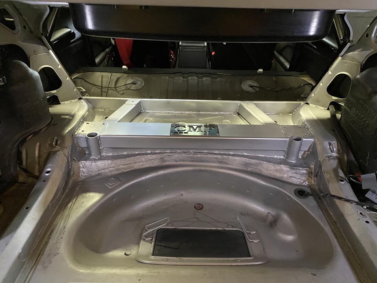

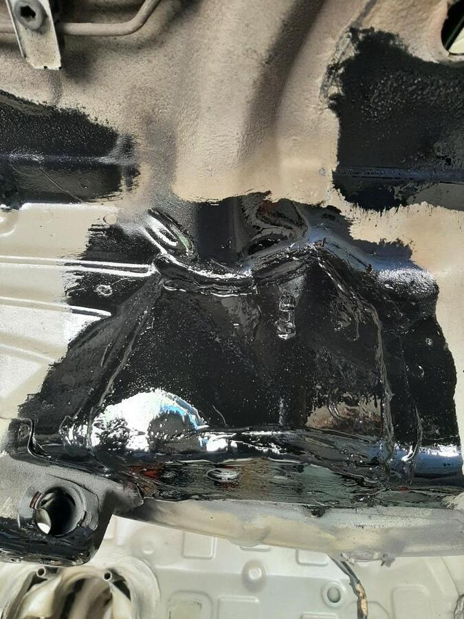

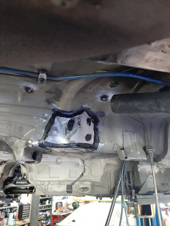

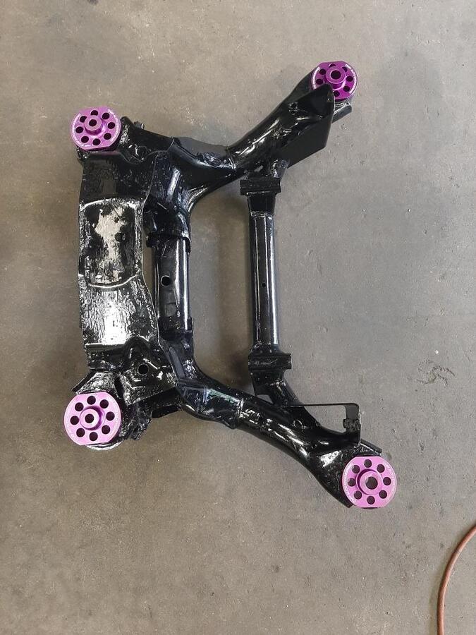

    I’ve been looking to do the full subframe reinforcement for a little while as I track the car from time to time so I finally bit the bullet and got it done by Laszlo at Protodrive Autosport in central NJ. I know there are many solutions out there and even more discussion topics on which one is the best one. After doing good amount of reading on forums and different websites, I decided to go with CMP and do both the topside beam / front cups and bottom plates. It might be an overkill but I don’t want to have to do this again. Another consideration was if I get more into tracking and want to get a welded cage, this could be a good welded solution to connect to down the line.
    Also, did bunch of “while you’re in there” items as well (CMP solid subframe bushings, OEM diff bushings, diff bolts, tack welding RACP pockets, front sway bar mount reinforcement, refinished subframe (POR-15), etc.
    Interesting part, no noticeable cracks…for a 2001 manual with 90k miles (in case anyone was interested as I feel it’s a lottery with these cars). Here are some pics…I’ve been looking for them when I was thinking about doing this so wanted to share with the community.
    Lastly, Laszlo was great so feel free to contact if you’re thinking about getting this done in NYC metro area.

      Very cool. I feel like that’s the best kit available although I’ve been away for a few years. I also feel that the top beam is the real fix with the bottom plates really just backup, rather than the reverse. If I had a car with no obvious cracks I’d skip the plates and just go top beam and be done.
      edit - except the right front mount gets smashed upwards during hard launches/shifts so there is a case for plates

        I wonder when doing the top part of the kit only (have plates done already) how much you need to take apart (tank, subframe, parking brakes etc…)?

          Despite the e46's structural shortcomings I'm still of the uncommon opinion here that the major contributor of this issue are worn out stock carrier bushings. You can reinforce the car until your blue in the face but the carrier will still hammer the panel with every torque input. Also there is no data on whatever the flavor of reinforcements the forum favors with worn out bushings. Now that would be truly interesting to me.
            jet_dogg Eh, it's all guess work really because no one has tested it properly. But I would hazard to guess if you drove a car hard for a while the RACP would start to crack and separate regardless of how fresh the bushing is. Fundamentally the RACP is just not well mounted to the chassis rails. There was a rear brace in the M3 GTR strassenversion for this reason, but perhaps BMW didn't expect the oversight to become such a big issue on street cars.
            Speaking from my own anecdotal experience, my car had some cracking so underside plates were put in and all new bushings done at the same time. In less than 2 years of normal driving (no track use/hard launches etc) there was already secondary failure at the wheel arch. This could be an issue with having plates and nothing topside to reinforce, but would at least suggest to me that the bushing are definitely not the primary contributor. I have since installed the complete CMP kit exactly as this thread outlines and it appears to be rock solid. If that doesn't hold the RACP in, nothing will...
              Interesting theory. My immediate reaction is even worn bushings are capable of absorbing energy which severely diminishes any kind of impacting.
                Pretty much everything has to come out again. The two front subframe studs have a hex portion in the middle, so they can't come out unless the subframe is moved out of the way. And they need to come out as they get replaced with the longer studs that attach to the top bar.
                You might be able to get away with just lowering the subframe, but the amount of extra effort to completely remove the subframe vs just lowering it is very little. Might as well remove it entirely and save yourself the struggle of trying to work around it.

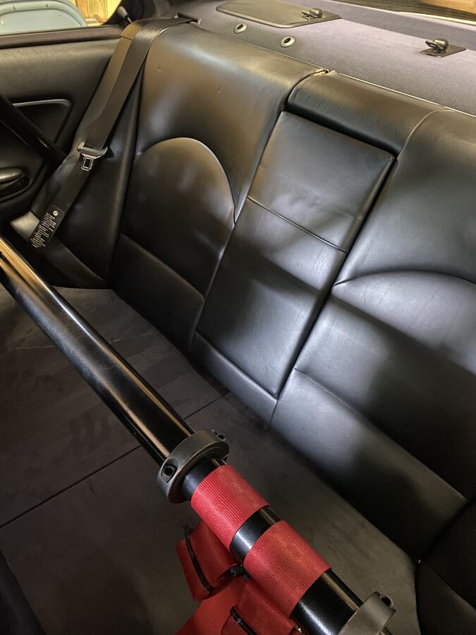

                  would love more detail on that rear seat delete.
                            It’s just perforated hardboard wrapped in alcantara. Used cardboard to get the shape right first…it was a quick arts and crafts project to cover up the bottom portion of the rear seat. PM me if interested and I can send additional pictures.
