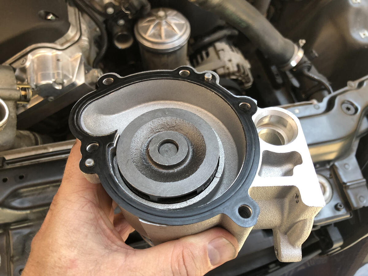

    You’re both right, it’s glass filled plastic / composite. Same thing. That’s what the “PPS-GF40” designates
      #47
      That’s a cast metal impeller
        #48
        Sounds like case solved.
          #49
          What was the solution?

            OP has non-oem metal impeller water pump which theoretically flows less than composite impeller oem.
              #51
              Its not as clear cut as Ian makes it sound as I'm yet to make changes and confirm they have any effect. Though likely he is correct, I had this pump installed for a while and never experienced any overheating before. So, while the pump might not be helping the cause, it is certainly not the main (or the only) culprit here.
                #52
                Yes it's radiator, but I would still return pump to fcp and get oe.
                  #53
                  Yep, that's the plan.
