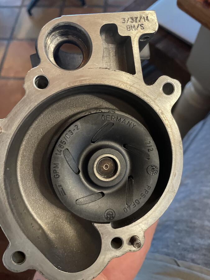

        The pump is Saleri. It was best that was available at the time I did this, as my original failed, so had no choice. As far as I know they are fine pumps, but I'm open to replacing that if you think otherwise?
        Saleri looks (FCP pictures) to use a metal impeller, so almost certainly flows significantly worse than stock.

          The picture above is the actual pump I have installed, its my picture of my pump. Does not look like metal impeller, but I'm no expert.
            Why is metal impeller pumps have worse flow? I though the culprit with metal impellers was premature bearing wear due to weight of the impeller, not flow?
            I didn't see your picture when I posted my post above-- agreed that looks composite.
            The composite impeller exists because BMW couldn't get sufficient flow from shapes they could make a metal impeller, so seems unlikely the aftermarket was able to do better.
              #36
                I don't know, that looks like cast metal to me. But also hard to judge from a picture.
                  #38
                  That don't look like composite to me.
                    #39

                          I believe this is OE pump with a plastic impeller.
                            #43

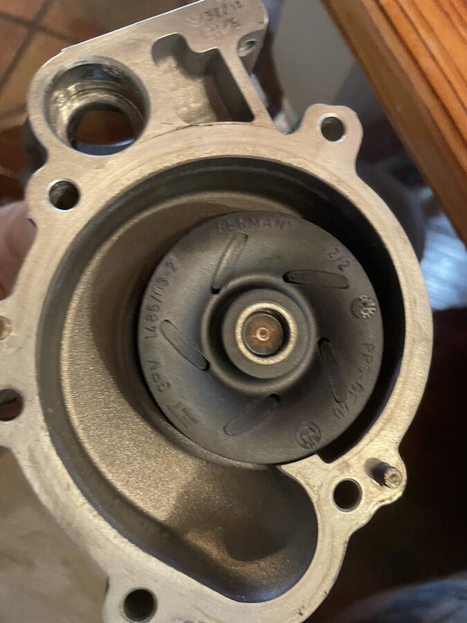

                            OE impeller.
                              #44
                              OE impeller.
                              Right, that looks plastic to me, unless I don't know something.
                                #45
                                Composite
