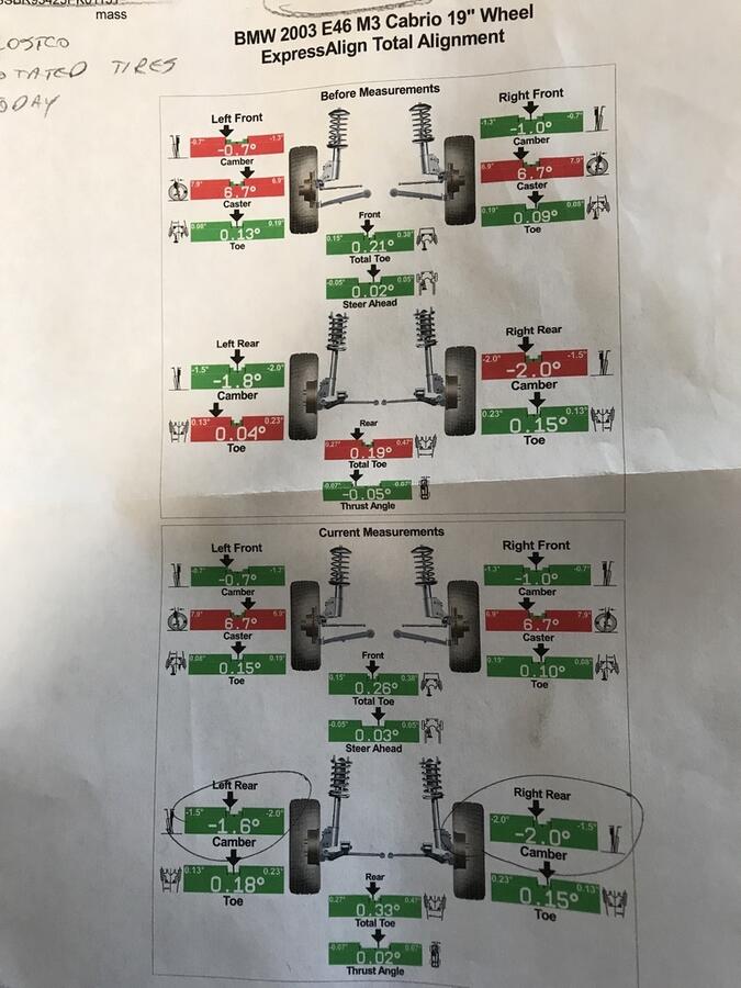

    Sorry about the errors and confusion. I'll never get how to post my photo's, but here's the numbers from the current alignment done January 2019: Looking only at the rears: LR camber -1.6 degrees, toe +.18 degrees. RR camber -2.0 degrees, toe +.15 degrees. Total toe +.33 degrees. As mentioned elsewhere, I drive this car like a sissy, but acknowledge driving habits can factor into this question. Bottom line, if the current specs look OK to the crowd, and I need new tires soon, I'm asking for recommendations for other than the Pilots I now have.

            Your rear toe alignment spec is ok, you could run 0 toe in front on square setup and rotate. That said, 6k miles on Michelin A/S tires - something is definitely off, they should last much longer, they are 500 wear all season rubber with 45k mile warranty. Check all bushings and ball joints.

              Separate note - looking at your numbers you posted - toe variation of a few hundreds is ok, camber variation of several tenths - makes me question why, normally alignment shops are able to get the camber spot on, maybe 1 tenth diff right to left - yours is almost 0.5 degree. Was your car ever hit/in accident/bent frame, bent salad tongs (lower control arms), some busted/cracked bushings? I'm assuming on those tires you don't drive it too hard to actually feel if anything is loose?

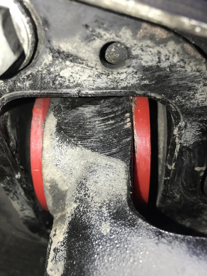

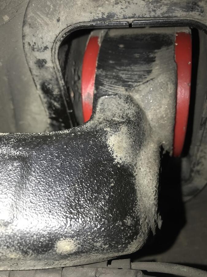

                worn RTABs for sure is causing all this.

                    Aftermarket poly RTABs could be shot already.

                      A "street car" alignment will not always have an even camber/caster setup. In a perfect world you would and roads would be flat. But because of road crown with an even alignment the car will tend to drive to the right. A common trick is to add just a little bit of pull to the left which will help the car drive straight on crowned roads, this can be achieved by variances in the camber/caster side to side.
                      *edit - note, this would be done to the front, just a fyi.
                      Maybe I missed it, but is the car lowered or had adjustable LCAs in the rear? Thats a decent amount of rear camber for a stock setup.
                          He only posted rear numbers.

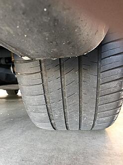

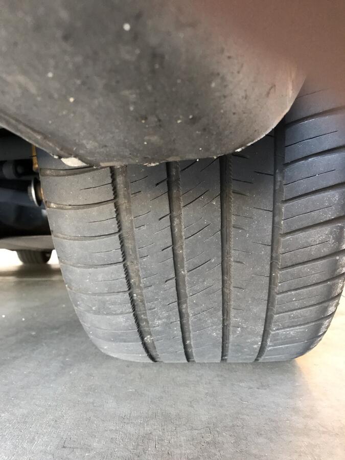

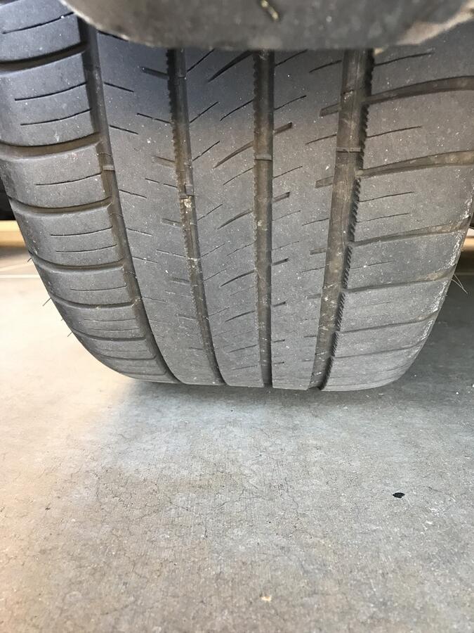

                            Probably RTABS, yes, but can you show a pic or define better what "worn" means - is it across the width of the thread that they are 3/32 or just inner edges? Also, assuming front tires were installed at same time - are those not wearing as fast, I didnt see a mention? Asking because your post only refers to the rears, but how are fronts doing in comparison. Given your driving style described, you probably dont experience power slides or wheel spin in rear to cause additional wear.

                                OK, guys, hopefully, here are photos of the rear tires, RTABS, and the shop's complete spec sheet. I measured both rear tires with an accurate scale, and the innermost groove depth is 3/32, outermost is 4/32. The RTABs look pretty good to my untrained eye, and I don't know the brand name. They were installed by a very reputable shop in Seattle, so I'm guessing they are quality units. If I can add anything further other than whining, let me know!
                                Steve
