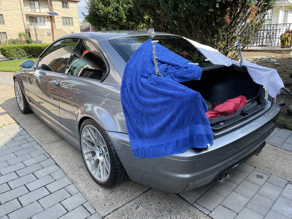

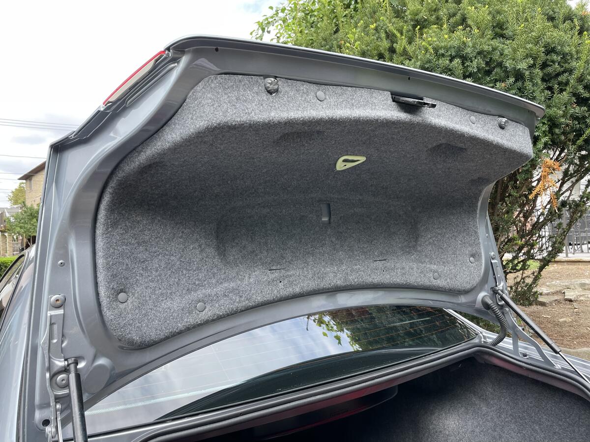

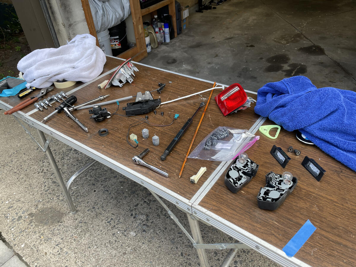

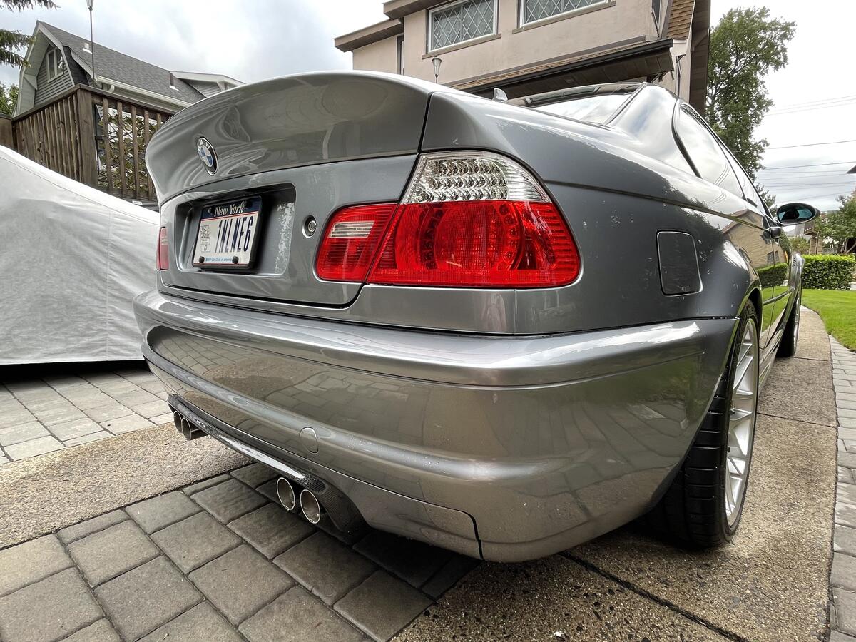

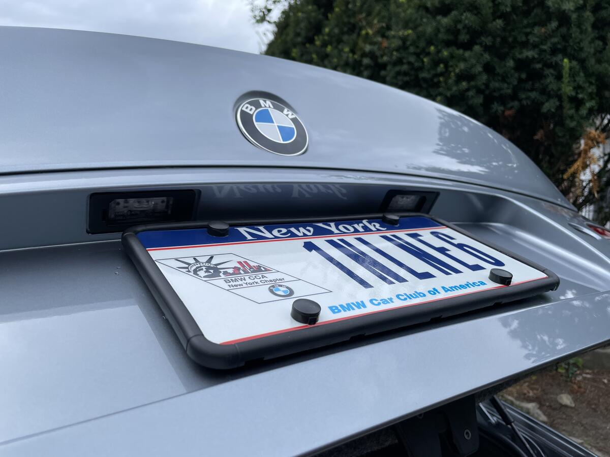

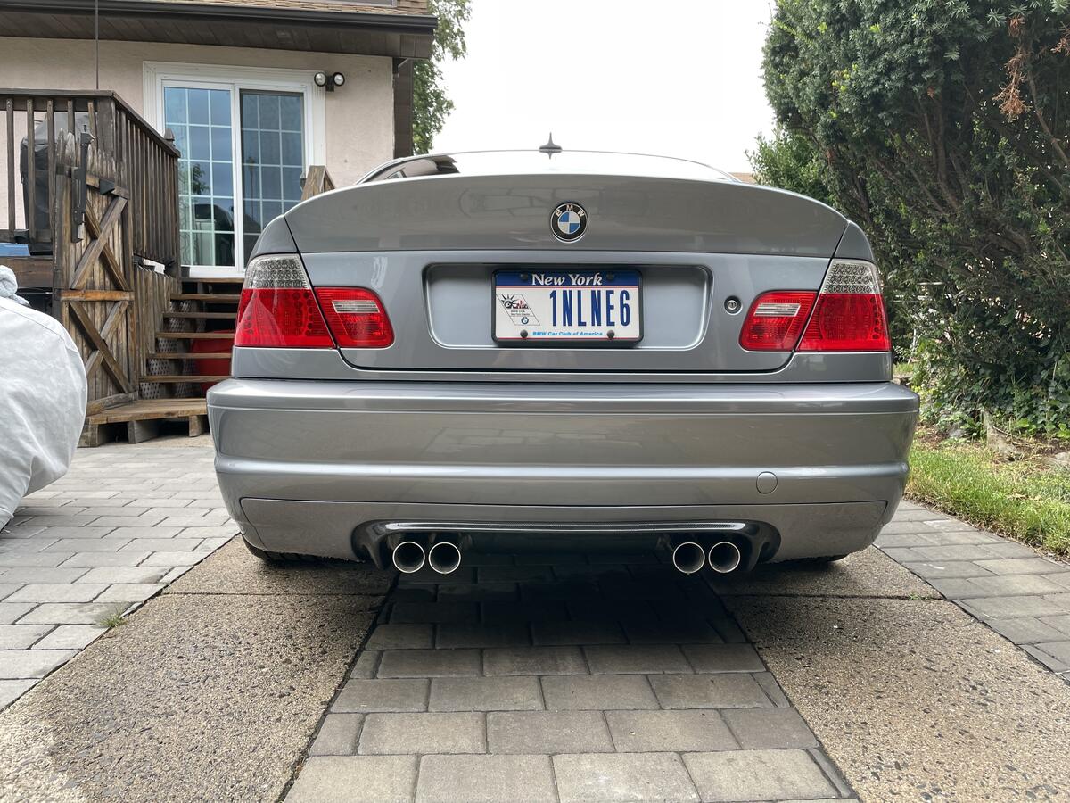

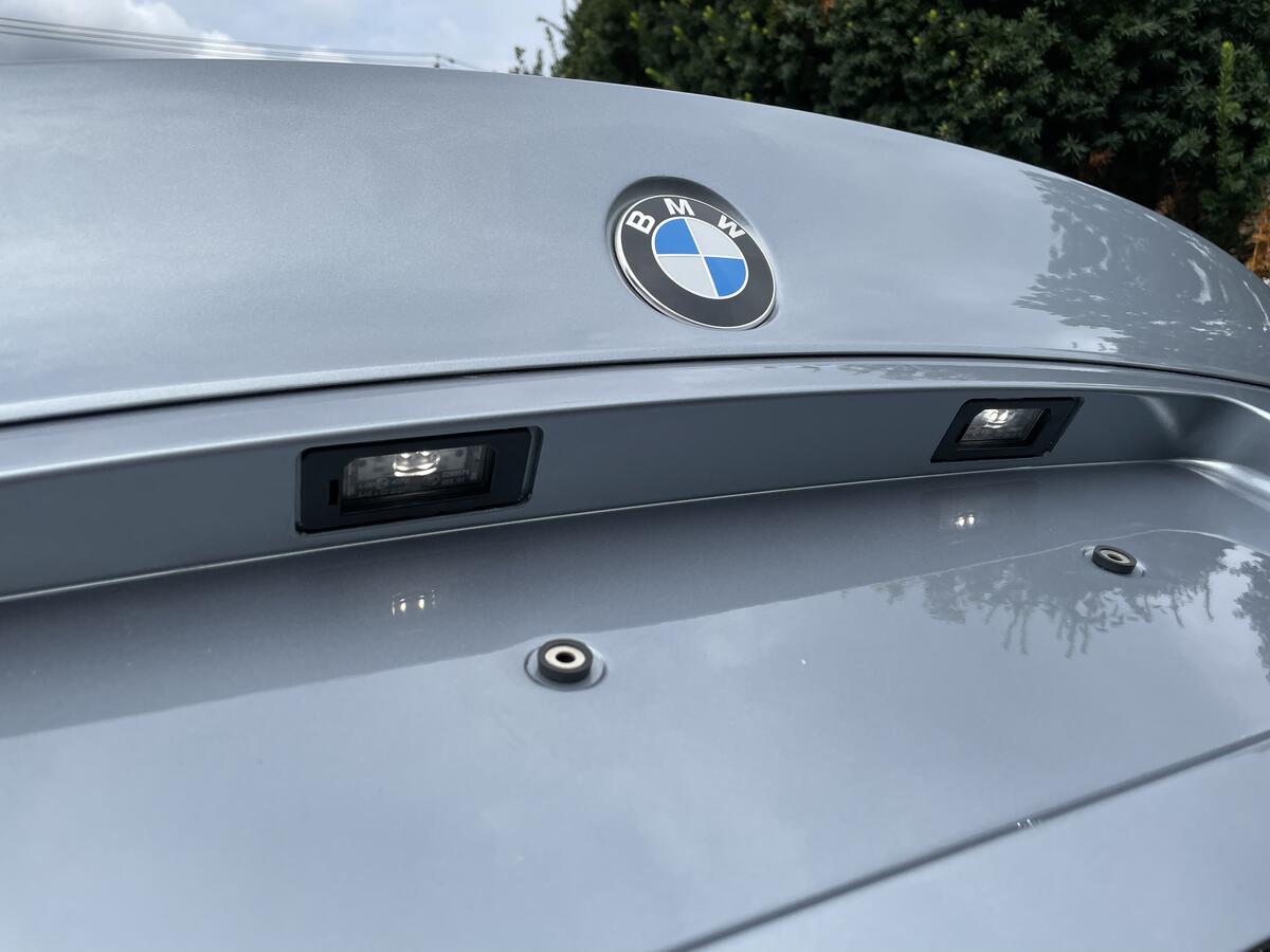

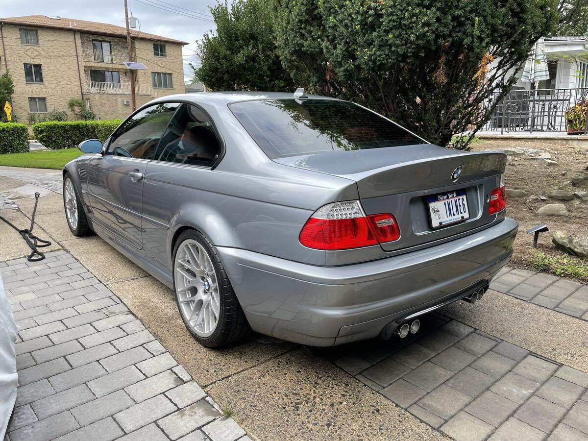

                Installed mine today. Spent some time fine tuning the gaps, and got it to where my OCDs are fulfilled. Comparing the Vorsteiner to oem, the oem trunk def has a lot more imperfections in the mold than i expected. Edges are def not as smooth as the Vorsteiner but fits slightly better than Vorsteiner. Not by much though.
                Had to dremel a bit of the license plate holes to fit the E9X lights & used clear silicone around the edge of the lights to prevent water from entering
                Also had to trim a bit of the backside of the trunk behind the reverse lights...to fit the bulb holders in place (not sure if that was necessary, but couldn't get the holder to clip in all the way without trimming a bit)
                I chose not to dremel the square for the tool trunk......and I'm ok with the stock carpet in place.

                  Trunk to body alignment looks spot on.
                  Not criticizing, but think you might want to adjust your trunk lights/tail lights.
                    #69
                    Color looks off to me, that would annoy me endlessly
                      I think that's the OEM fit of these things, they're always just slightly higher than the body taillights.
                        #71
                        yeah i was messing with that and to be honest i wanted the trunk taillights to be centered to the opening. By lowering it down, the gaps around the opening would widen and not be even
                          #72
                          you shouldve seen how off my Vorsteiner was. What i come to find out is Silver grey is a tough one to match. Every shop by me wanted to blend into the quarters, but i def didn't want to
                            #73
                            Ahh just looked, yes indeed they are.
                            I see your point. Never noticed before, mine are lower to line up but not centered. Please disregard.
                              #74
                              Install & color match looks great, ignore the peanut gallery. Color matching silvergrey is nigh on impossible.
                              Yes, the CSL boot doesn't line up exactly perfect with the rest of the QP/lights. Look at a real CSL.
