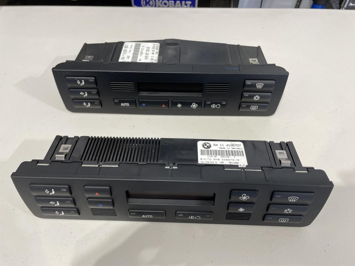

          If it helps anyone out since it may be that the earlier versions of the updated IHKA may not work (if I read Ted's comment correctly), here is a photo of my original unit from my 12/2002 built coupe (background) and the replacement IHKA (foreground). Note the date stamp info on the updated unit. Zero issues since upgrading. I pulled this one apart and cleaned the temp sensor and I think it actually functions better than my original unit.

              What PSUEng said is correct -- IHKAs made after 09/2003 do not have this bug. The problem is that the LSZ I/O status response message, to make the comfort blinkers work, is longer than they programmed the IHKA to accept which results in undefined behavior.

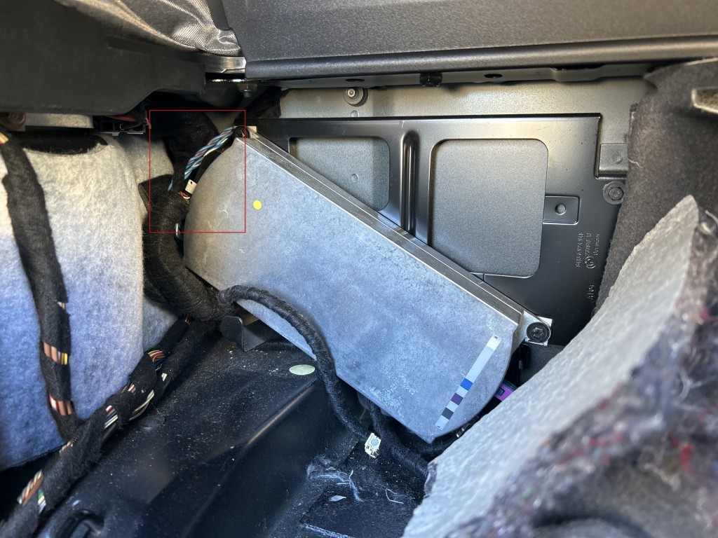

              Does it have the oval mirror or the mirror with the SOS button? If it has the SOS button, then the connector is probably already connected to the BMW Assist Module (TCU):
              Click image for larger version  Name:	E46_Vert_TCU.jpg Views:	0 Size:	217.2 KB ID:	303330
              Thanks!
              -Ted​
              Ah, yeah I have the SOS mirror. I see I can remove the TCU completely and connect the cables to the bluebus.
