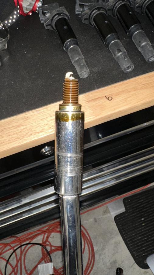

    Pulled the spark plug from cyl 3 and sure enough there is oil on the threads again. Not nearly as much as the first time, but the plugs are only 4 days old.
    Other than spilling oil down the tube, what else could cause it? The only thing I can think of is valve seals.

    Before installing the new plug, did you try to clean the plug hole and the female threads? It could be that at the bottom of the hole, the sealing surface has scratches and so the new plug crush washer didn't seal well. I don't see how the oil can enter the hole from the top. The only way oil got to the plug threads is that gas is leaking through the plug threads and the crush washer.

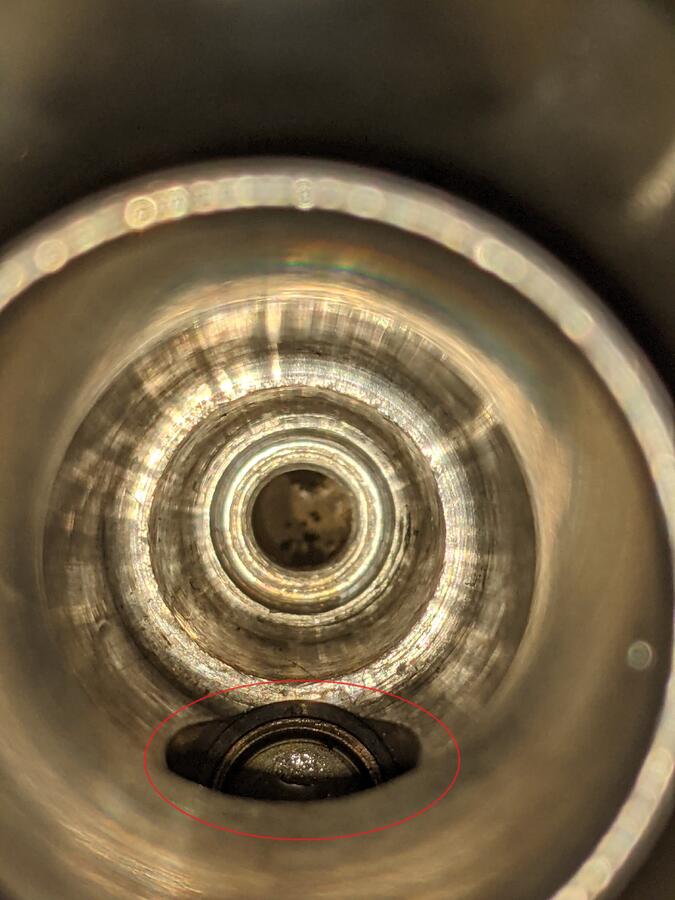

        After taking another look I think the oil is indeed coming from the top of the plug and dripping down. The plug tube on cyl 3 is unique. While the other tubes are solid, #3 has this cutout in it. After driving a few days and then removing the coil, I find oil pooled up in this little dish. I think it would be impossible for oil to come past the threads of the plug and make it's way all the way up here. Anyone know what the purpose of this cutout is and what's supposed to be sealing it?

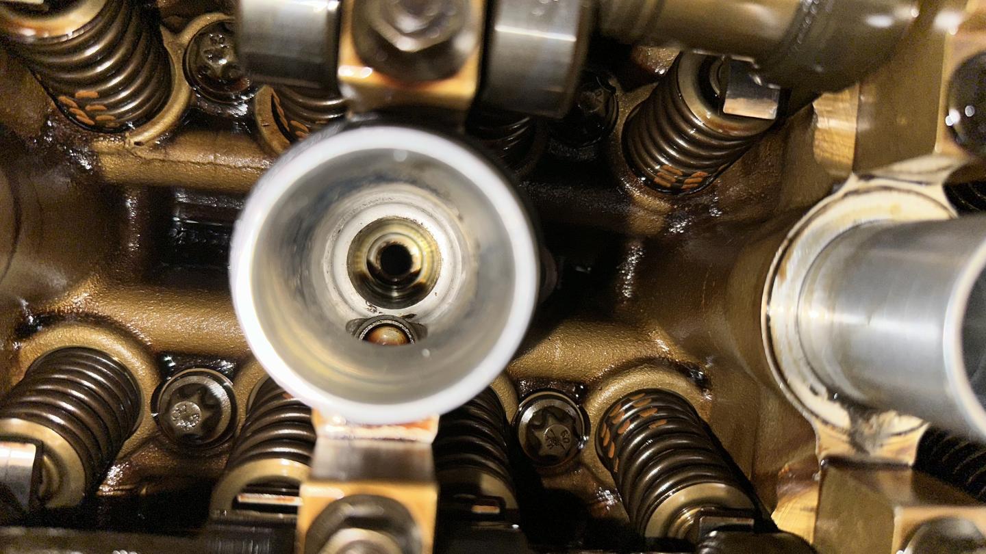

          It should not have that cut out on the head. Remove the valve cover and look at the base of that #3 plug tube. How high the cutout is from the plug crush washer base? The leak in oil flood the hole until the oil was high enough to touch the plug tip, then shorted out the high voltage and discharge the spark into the oil pool ---> misfire. The coil should be good still.
            Pretty sure all s54s have that cutout in the spark plug tube for cylinder 3. I was just messing around in there and mine definitely has it.
              Did you ever figure this out? I haven’t gotten to the point of misfires but I’ve got a bunch of oil pooled in that little cup as well

                A small amount seems pretty normal, especially on a higher mileage engine. My guess is the oil vapors are making their way up the cylinder from the crankcase when the engine is shut off. Initially I thought it was from the valve cover spark plug tube seals, but not sure how the oil vapor would get past the sealed coil packs.
                  same i also have this cutout
                    Makes sense to me. I haven’t had any oil consumption issues at all. I was just doing a vanos rebuild/service ii and saw oil collecting there. The coils didn’t have any oil inside them so I’d assume it’s not getting past them.
