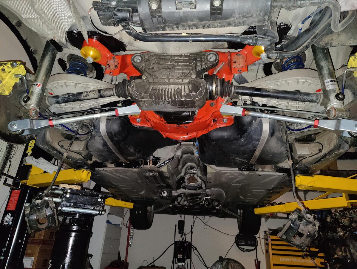

                  I used them on my car and they have quite a few options for each setup.
