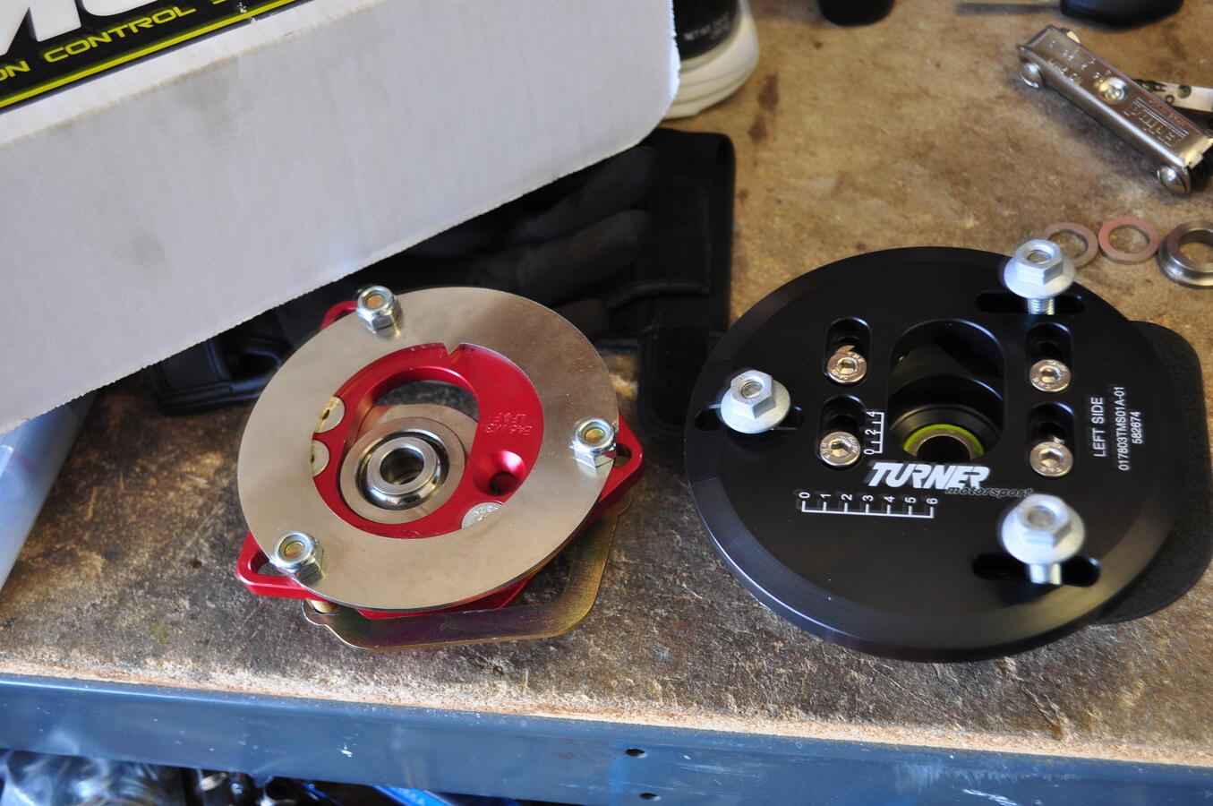

      Did a canyon run a few days after the suspension changes, and really disliked the lifeless steering feel I was getting. It reminded me of when I tried the TMS monoball FCABs. I figured it was the spherical camber plates. I was very happy with the previous TMS plates (poly bush), so I bought another set ("street") and sold the Vorshlags to a friend.
      You can see the much larger footprint of the TMS. Despite the disparity in size, the TMS are no heavier than the vorshlags, luckily. Gonna miss the vorshlags, they really really nice and well made.

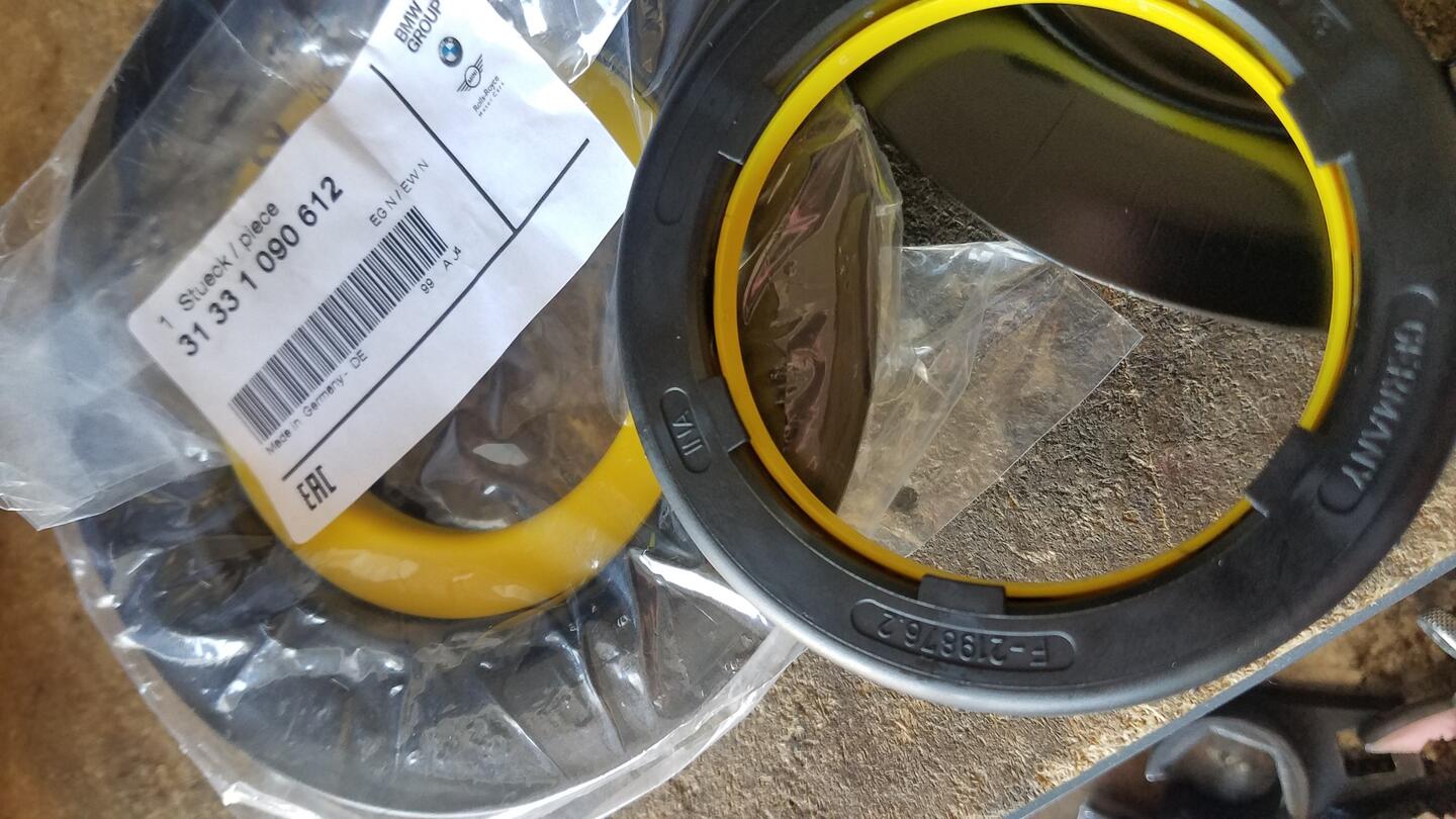

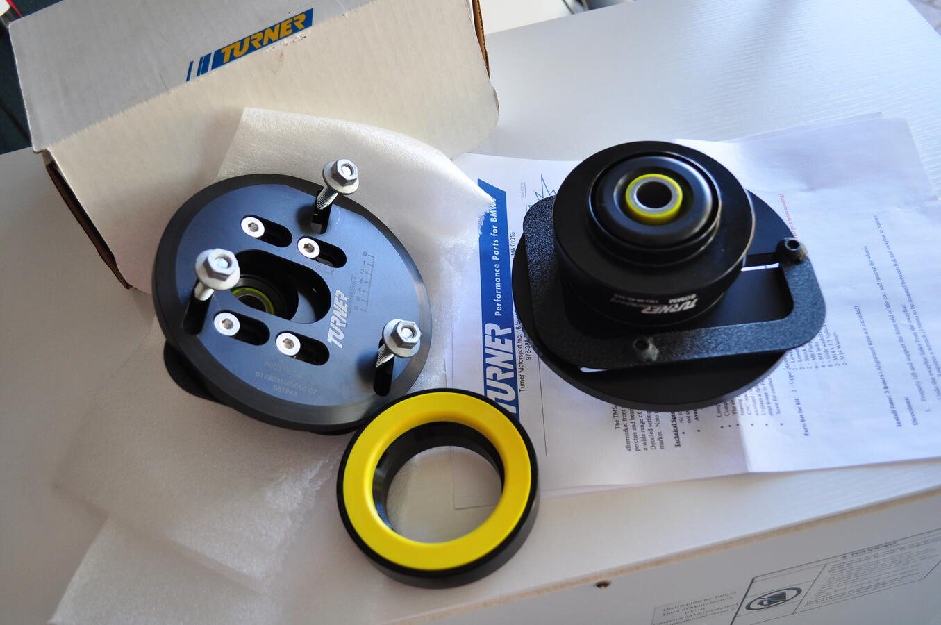

      The TMS plates are quite a bit more expensive than other options. Worse still, they don't come with the necessary upper thrust bearing. Turner gives you the option of buying them, but they word it as "perches." Well, I didn't think I needed it because I didn't want stock perches - I'm using 60mm springs. Turns out the BMW part is a combo, it's the black metal spring perch WITH the yellow/black bearing.
      So I ordered a new set of perches/bearing for $40

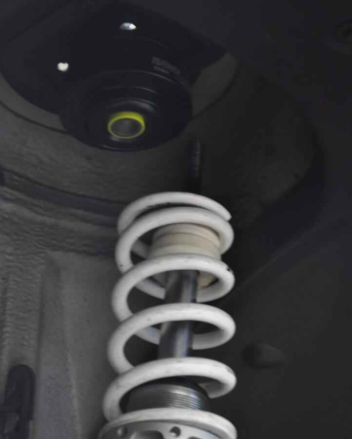

      I hadn't gotten an alignment yet, so no biggie dropping the other plates and putting the TMS in
      Click image for larger version Name:	TMSplates03.JPG Views:	0 Size:	31.4 KB ID:	133590
      Not quite as pretty as the gold and red of the vorshalgs And the plates' studs are unnecessarily long.

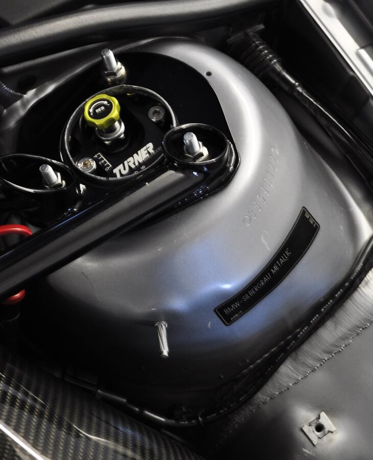

      All done. Hopefully, this is the only change I need to make to be all set and then get an alignment.
      Click image for larger version Name:	TMSplates01.JPG Views:	0 Size:	162.7 KB ID:	133592
      Happy to report, the car feels great again. I've got the spherical RSMs and bottom shock attachment, but they don't ruin any perception in "feel." I'm all about the feel and the sound aka the "experience"
