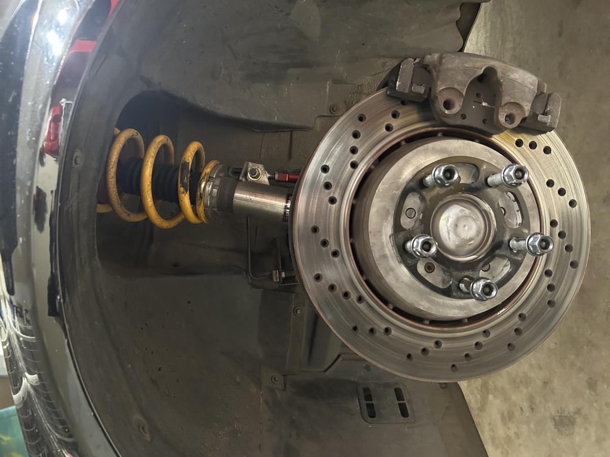

    Finally got back to the M3 this week.
    Ohlins E9X front springs installed. The front upper rubber spring mounts was trimmed slightly and they went on without issue.
    In short, the slightly softer e9X springs make a world of a difference. It was a game changer.

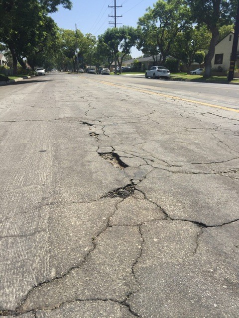

        Bumpy roads were my problem. For those of you that aren’t familiar with Los Angeles, the roads are truly awful. Think budget cuts meets warzone. At the Ohlins stock rates (400/630), my car was constantly in motion and absorbed nothing. Felt like I was on horseback.

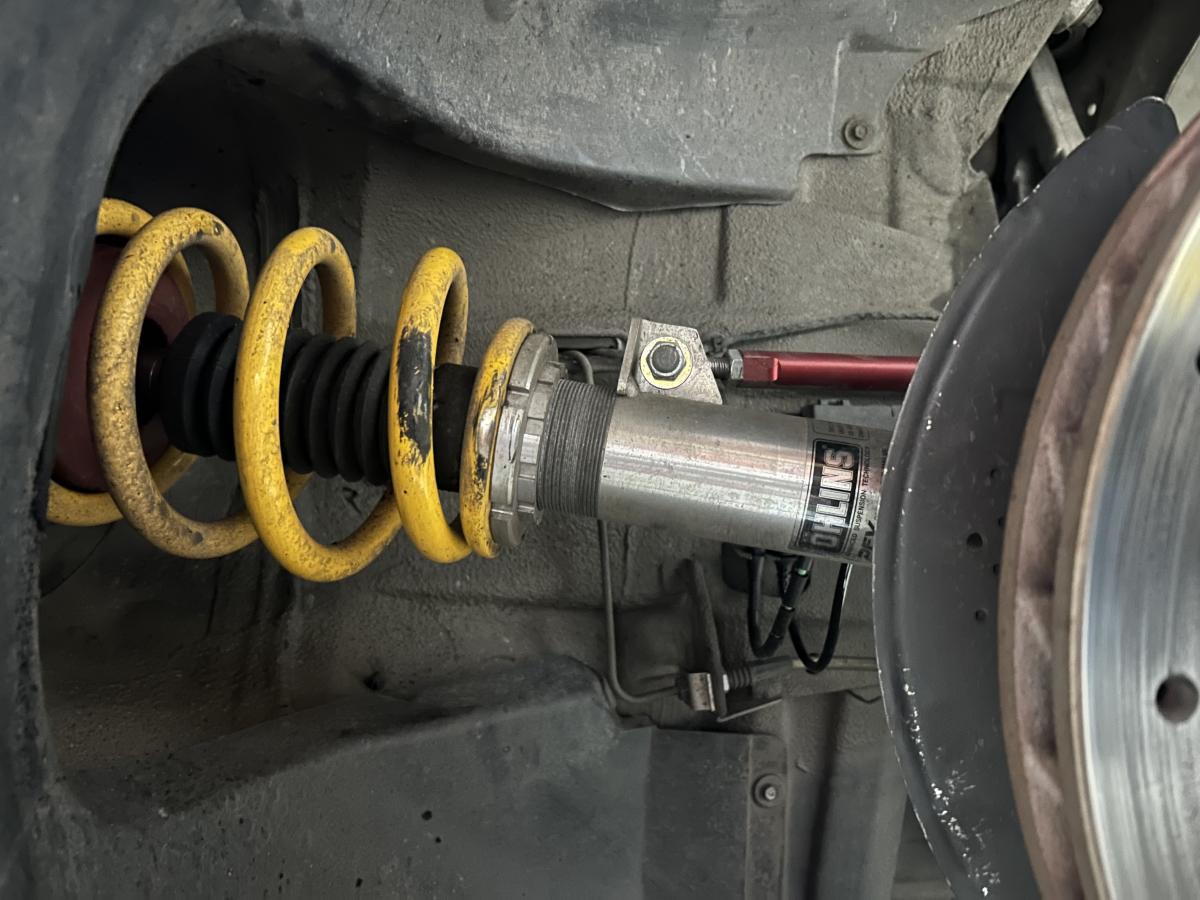

              Disclaimer: I am (hyper) specific about suspension setup. I want things firm but compliant. I want to feel the road, but don't want to be disturbed by it. I also like to run higher rebound than others, data be damned. At 10f / 11r clicks off from full stiff with 500lb rear springs, the ride is sublime.
              No noise with the e9x front spring? Think Barry is able to get these? Also what's the custom trimming look like? I love my ohlins but I always feel

                Yep—the busy feeling drove me crazy. The car still moves over undulations but it’s less of a disturbance now and feels
                more composed.
                Barry and I are connecting on Monday to discuss spring inventory. I will report back.
                In terms of noise, I did notice a slight clunk or two when turning the wheels to parallel park last night. Not offensive and a trade off I’m more than willing to accept.
                The trimming sounded minor, but my shop
                handled it. They certainly didn’t complain about the job. I’ll ask about that as well and revert. Though I don’t think this was a custom, one-off tedious headache.
