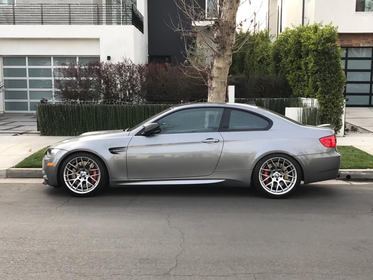

                I had Ohlins on my ZCP e92. They were infinitely better than EDC.
                I haven’t had a better handling, better behaved car than that e92. Some cars do certain things better, but none have been a better total package (admittedly, with all my mods).

                        To bring things back on topic, stock vs stock, the e46 is better (imo). When modded, the e9x is tough to beat. Ohlins on the e92 resulted in the go-kart-like chassis we love about the e46. It made the car feel less fat/bloated.
                        I laughed the day I drove home from the shop after unmodding my e92. Having driven the car on point for so many years, I couldn’t imagine someone trying to tell me the car was “good” as stock.
