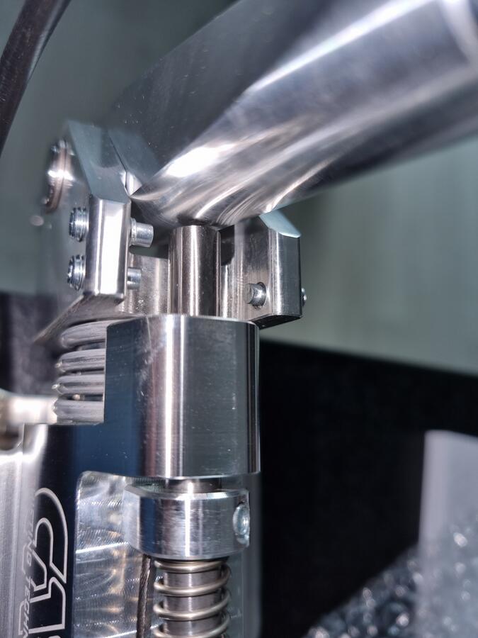

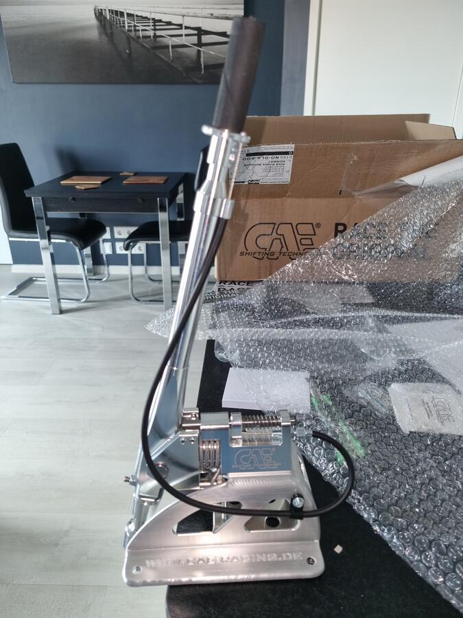

                              For those who might still be interested and following. This 1/2 and 5/6 gate from the CAE version had me intrigued, so much I treated myself to one and express shipped it to me this week. Will install tomorrow.
                              Quality is really good, but to be expected, but I don't think RTD's version is any less so, the main difference is CAE is aluminium and RTD steel. RTD is a MUCH easier install though, and RTD I got with a metal head, whereas the CAE is some sort of plastic thing (not pictured btw).

                              Why CAE isn't pushing the adjustable gate side to their product is beyond me, it's pretty much unique to have this much adjustability:

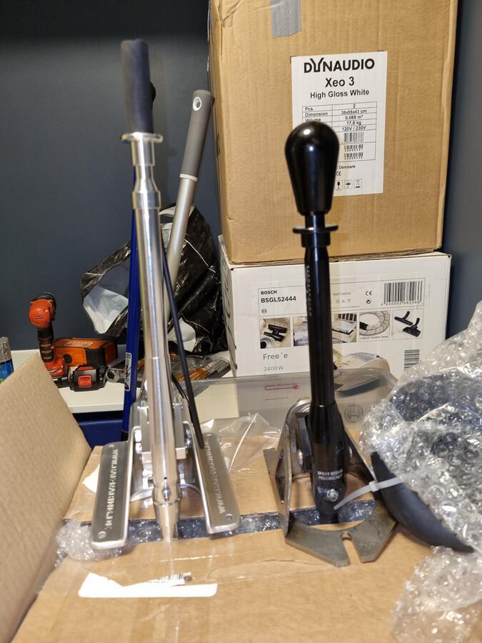

                              Full size CAE vs "street size" RTD. Not crazy different, but I think I should have gotten the shorter CAE version, but at the time of ordering (1 am), I for some reason thought only the long version had the gate adjustability. Hey ho.. I'll survive.
