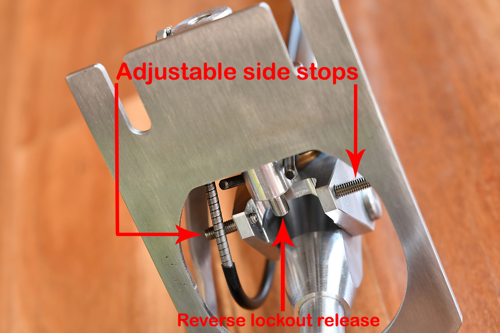

    I thought the RTD did have gate adjustment. Just not as refined to be able to stop how far to the side it can go when the reverse lockout is engaged. This is the pic I saw where I got that from.

              Yeah I'm guessing RTD introduced this on their locking shifter? But as you say only with right/left stops and no adjustable gate for the reverse it seems.. RTD is still a nice product IMO, but the added adjustability of the CAE version sets it apart from all the rest.

                    There is a solution to that problem and it is the self centering shifters that have gate definitions, i.e little pins/screws that you can adjust. Not all of them have it... For example if you look at the Coolerworx street/short version, it does not have those, while the Pro version does. CAE does, I don't believe IRP or RTD have them. (random pic of CAE pins below as example).
