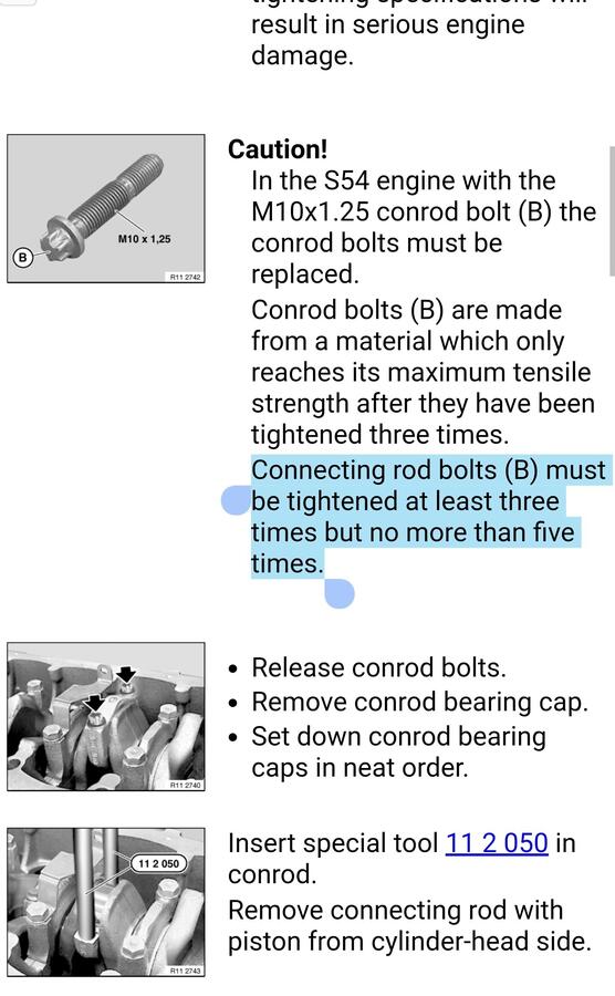

      This is what TIS has to say about torquing the M10 bolts more than three times:

        I did buy them from FCP. Good idea. Though it looks like I could do a 4th torque no problem.

            According to BMW, the bolts must be tighten more than 2 times and less than 6 times. So no risk if they are tighten just 4 times.
              Yes, I understand the instructions. But if that was the case why not just reuse the original bolts? They were likely tightened 3x in the past, so the could have 1-2 more cycles left. For $70 I'd replace them, its not like we are talking about hundreds of dollars in savings.
