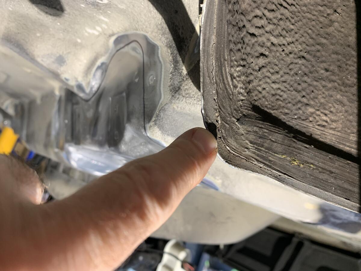

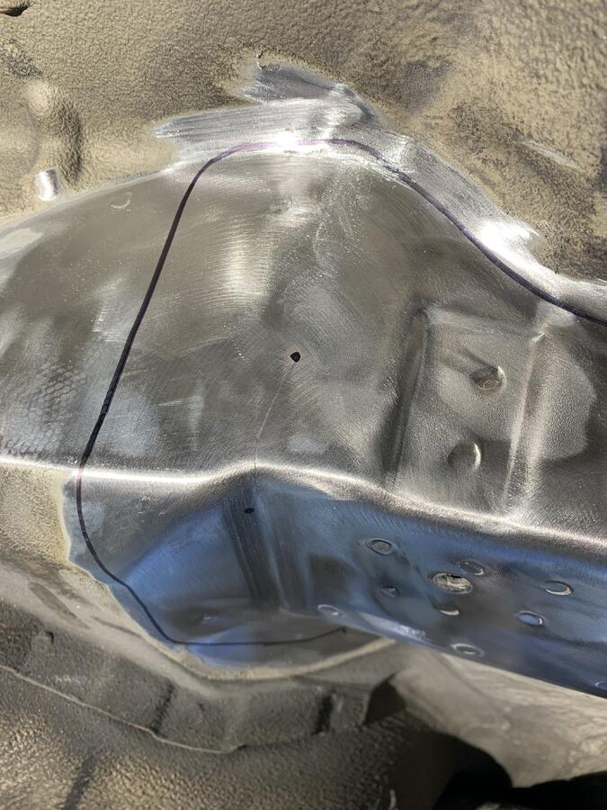

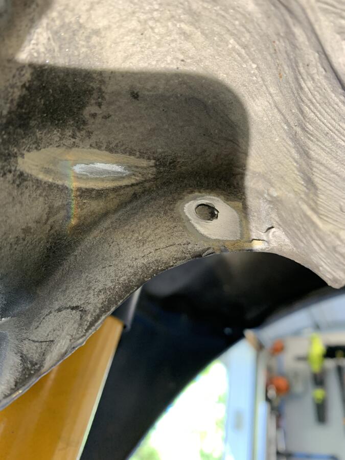

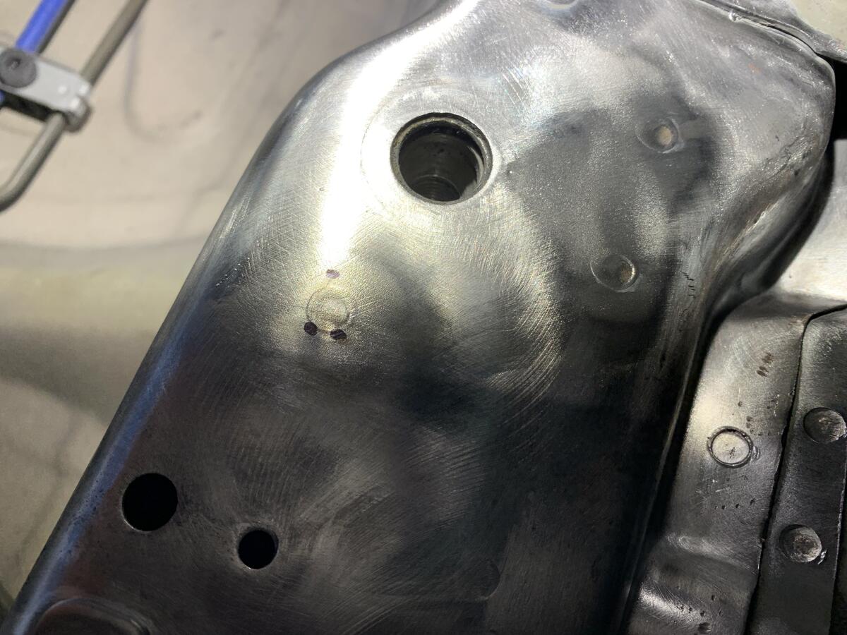

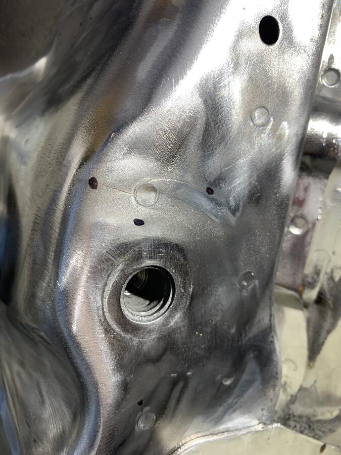

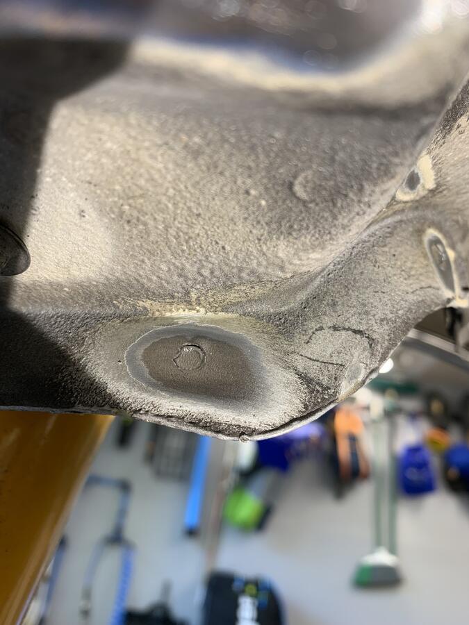

      Disassembly and prep for the skinz is done. I found just a few cracks. With all the horror stories out on the web I was pretty relieved with what I found.
