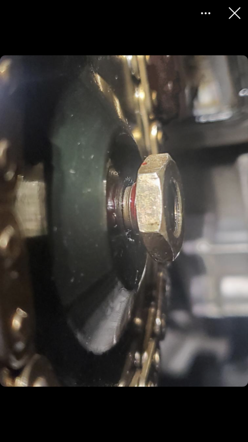

        Click image for larger version  Name:	BC5B798B-DB7D-4885-9592-DAAAACFB8E05.png Views:	0 Size:	368.7 KB ID:	127543
        Had a pinch of locktite added when I got my rod bearings done last month. I was told that it was overkill for the s54.
          I put a drop of locktite and torqued to spec when rebuilding my s54. Never had an issue. Never heard of it being an issue. Only did that as I was in there.
