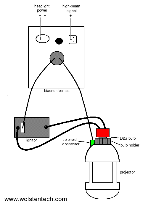

                        Jumping in here as I've had issues with one headlight lately. Initially when it went out I suspected the bulb. I got a pair of Philips Ultinon D2S (they look great!) but the problem persisted. As I started looking up ballast info, the bulb began working again... but only for a day or two. It's been a few months now and it mostly doesn't work, but once in awhile comes on for a couple days before going out again.
                        Questions:
                        1. Where should I begin looking? Ballast? Igniter? Wiring?
                        2. Is there a way to test, or do I just buy parts and see what happens?
                        2. Where are the ballast and igniter located? Are they inside the headlight housing?
                          Questions:
                          Was it ever ignited or completely dead? The igniter only work to ignite the bulb a short moment when first turned on, then once the light was on, the ballast takes over from here. So, turn on the switch at night and observe the light behavior.
                            Questions:
                            So from my experience, my issue lasted way longer than it needed to be because i didn't diagnose correctly.
                            Seems like you've changed the bulbs and the issue presisted, so the next step i would do is swap ballast from left to right and see if the problem follows the ballast or stays on the same side. However, from my experience, if a ballast goes out, it usually goes out for good and never comes back on. (but don't just throw money at it like i did and not diagnose correctly, lol)
                            And just a follow up from my original post... it was the bulbs - seems like they weren't in correctly and it kept shorting. I replaced teh bulbs, ensured they were in correctly and all is good!
