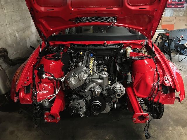

    I will remove the front bumper/clip per the below pic - it will look like that. I know I'll need an engine hoist. But I'm thinking about getting Quickjacks rather than relying solely on jackstands. I thought about building some kind of dolly to hold the motor and transmission as one unit, unbolt all connections (driveshaft, wiring harnesses, coolant hoses - everything) and then raise the car with the Quickjacks. Then I realized I'm probably way over-complicating this.

        Once you have the front clip off removing the motor is very easy. Engine mounts undone, prop unbolted, shift linkage disconnected, exhaust off (can probably even leave the headers on), and then all the connectors and ancillary stuff. There are loops for a hoist at the front and back of the motor, take the weight off and yank it out. No need for a dolly or anything?

          But yeah with the front clip off, you can basically just slide the motor forward and it'll come out (assuming you've undone everything that's holding it in).

                Taking the front clip off is trivial. Once the radiator and a/c are out of the way its like 8 bolts and the whole thing comes off with the headlights. I put the bare front clip back on for the body shop so the hood would latch and they could align hood and fenders.
                  OK I was waaay over complicating this in my head. I was trying to figure out what tools to start assembling that I don't already own. I'll rent a cherry picker and have at it. This sounds pretty straightforward, actually.

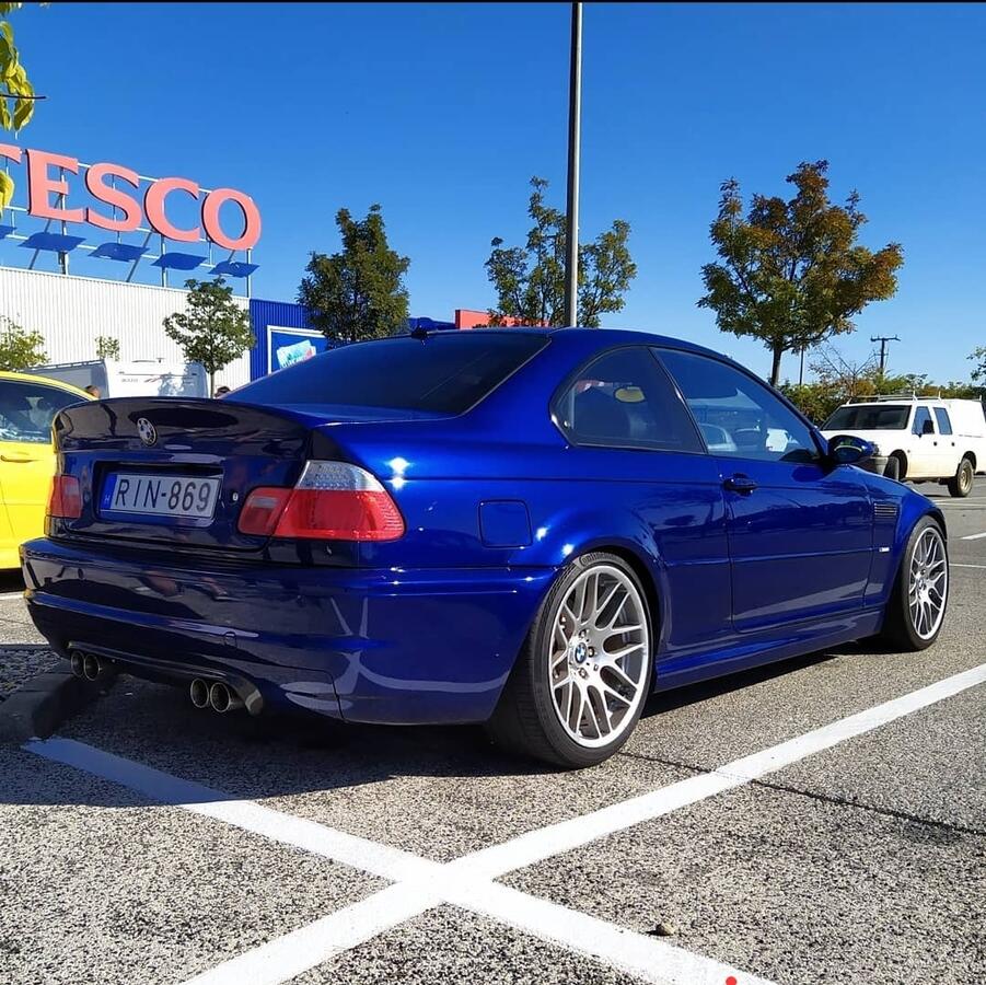

                      Topaz and Mystic are both beautiful and rare. If you want a cool blue that is BMW specific then try San Marino Blue off the F80 CS. IMO it would be look awesome and similar to Interlagos and very unique
                      Funny enough... someone just emailed me these pics of a San Marino Blue e46 yesterday. Gorgeous.

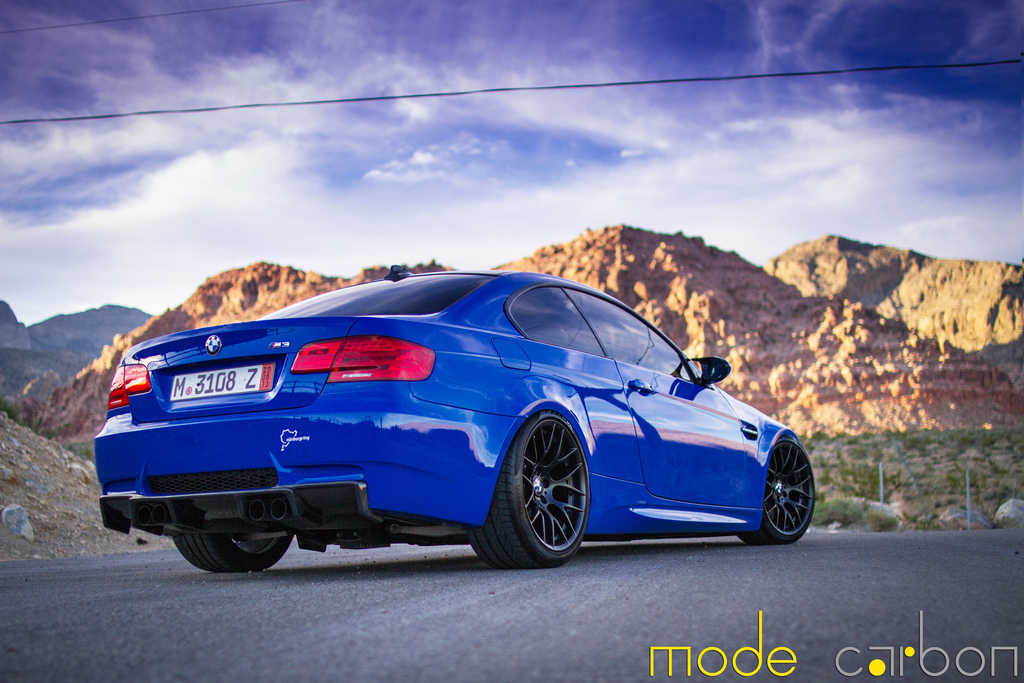

                            You can also consider Santorini blue from the limited edition E92 M3. Such a nice color!
                              Holy crap. That might be it.
