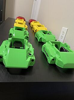

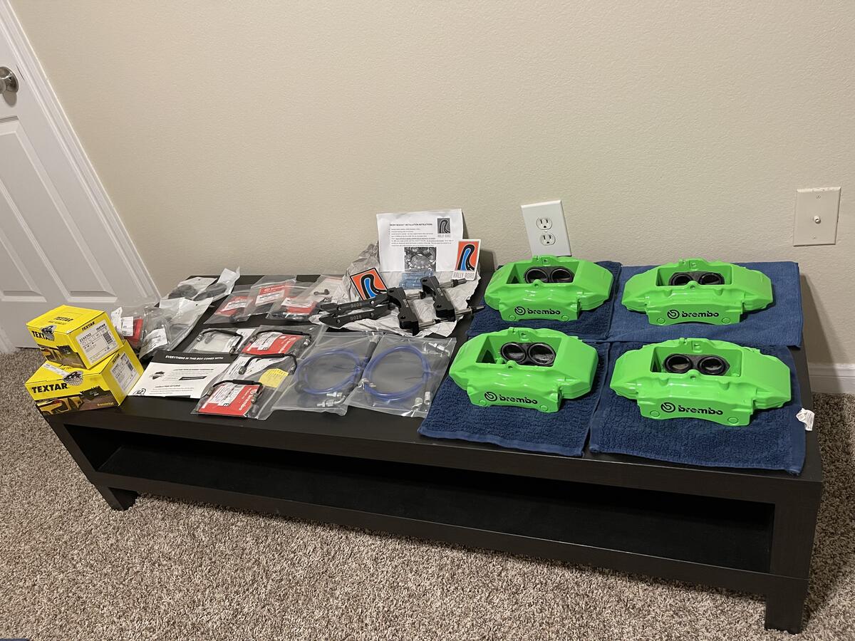

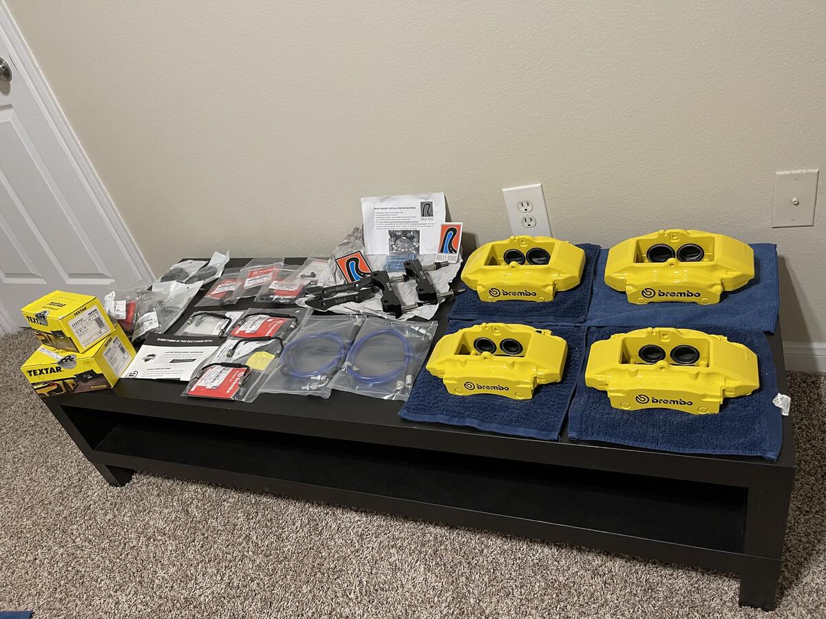

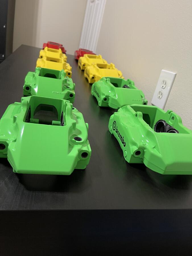

        Not the same level of stopping power but
        I have some 996 refreshed brembo’s (996.351.425 f&r set) for sale if anyone is interested

              DM’d ya!
                Got a bunch dm’s at once, gonna get my laptop out and start replying here shortly.

                  Do you think Brintech machines them for fitment on the E46 M3, or this is a bolt on? Maybe special brackets?

                    Are you still selling?

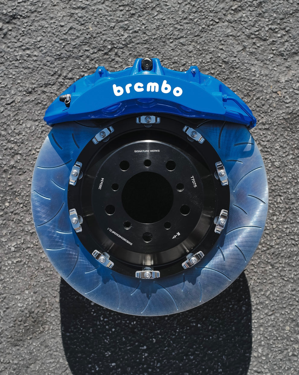

                      I realize this is an old thread, but are there any newer kits out I should know about?
                      I came across this, which seems like one of the few budget kits not using the 18Z calipers. Seems like a good setup for the price.

                        https://signaturewerks.us/collections/bmw-e46-m3
                        They basically pull from a Chinese source. Signature werks does nothing fabrication wise on their end. So their source machines down(bad) some ZL1 calipers and adds some brackets, then uses some huge 380mm Chinese(possibly not bad but probably) rotors to complete the kit. They do look nice though.
                        I'm in the process of collecting parts for an Alfa Romeo retrofit which doesn't require any machining of the calipers. Will review once done but basically you source Quadrifoglio calipers, freakyparts brackets, and e92 m3 360mm rotors.
                          This. They can't even get the logo to look right... brcmbo? I guess that's one way to avoid copyright infringement.

                            I have a spare set that I could probably sell if you’re interested. I think the only things that need to be done before install are shaving the fronts and front RR brackets.

                              That's the motorcycle branding. Pretty cool
