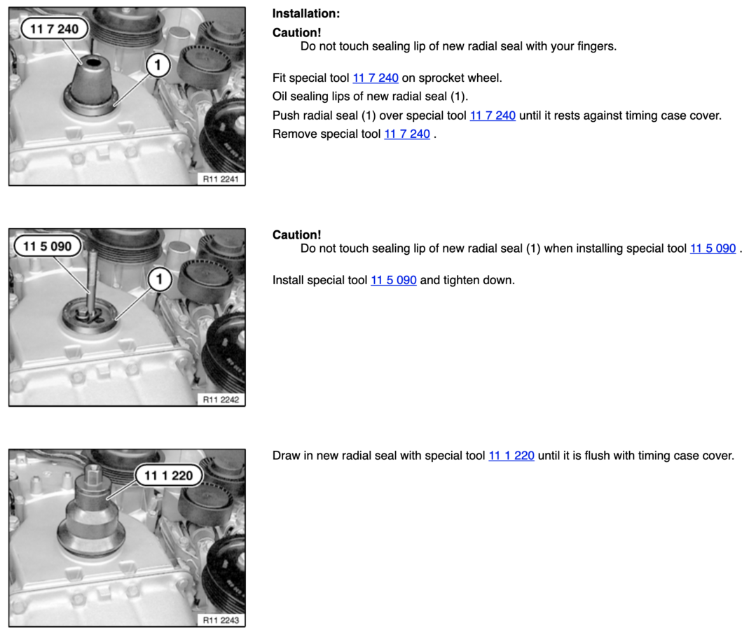

    This is what TIS says about it:

      I don't trust the TIS. It says to oil the seal and every seal manufacturer appreciate says not to use oil

        First step is to clean the bore and crankshaft sprocket really well with brake cleaner.
        Next step is to install the new seal onto the taper adapter. No oil or grease can be present. It must be completely dry.
        Then install the taper adapter onto the sprocket using the stock harmonic balancer bolts. (This pic was taken afterwards the seal was already installed...)
        Then install the press cup and press it in.
        The depth is very important. The timing cover bore is 16mm deep, of which the first 1mm is a lead-in chamfer. The seal is 10mm thick. The stock position of my seal was 2.55mm which is about in the middle. But you don't want the new seal to run on the same shiny groove created by the old seal. So it should either be installed shallower or deeper by ~1-1.5mm.
        I chose to install mine so it passed the lead-in chamfer but was just shy of the shiny groove.
        And here is the seal installed.
