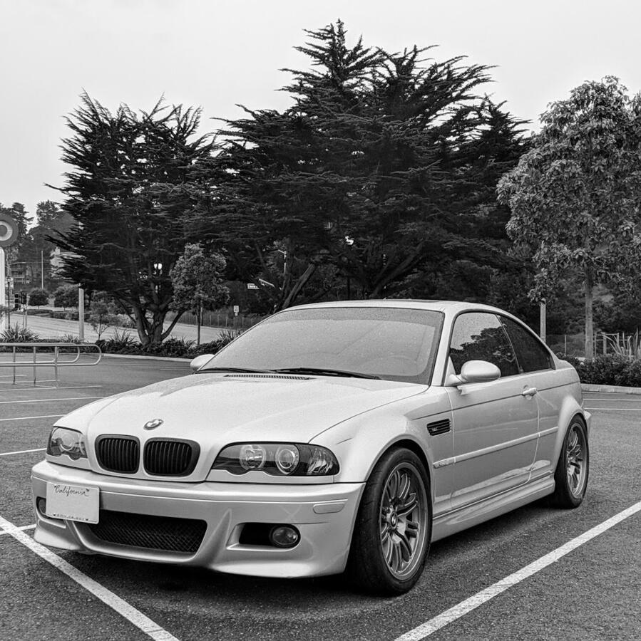

                          Here is my set up. 265/35/18, 3 deg camber F, 2.4 deg camber R, 10mm R spacer, slightly rolled rear fender.
                          2003.5 SG/Grey
                            Looks great. That's a lot of camber. Any issues with edge wear in the front?
                              Not really. The car does 3000 street miles and 1-2 track days a year though.
                              2003.5 SG/Grey
