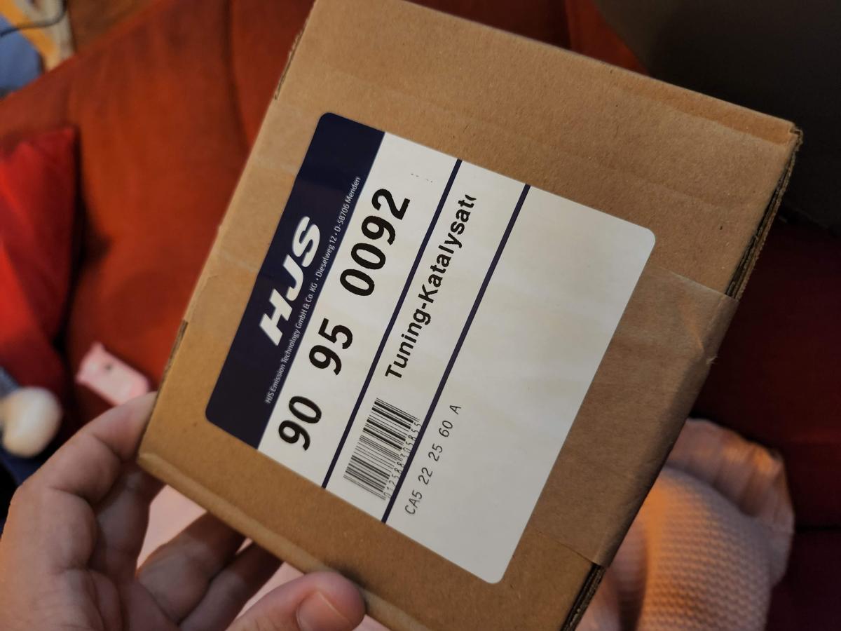

                            bring this old thread back up. reached out to a few members regarding their experience with fabspeed. results have been 50/50. i'm actually considering just buying the cats and getting them welded into my euro section 1 (clogged cats). from doing some research i dug up an M5 board post from HJS USA and they reference part no. 90 95 0092. specifically, they state: "Our model 9095 0092 HJS Hi-Flow Universal Catalyst can handle an engine up to 2.6 Liters and 240 HP, while two can handle an engine up to 5.2 Liters and 480HP. "
                            has anyone looked at what specific HJS cat would be a good replacement for our cars? for those with the fabspeed, care to share what it says the part no is on the HJS cat? shipped from germany i'm looking at about $1050 plus welding. yes, some can say it's not worth it, but considering 1)fabspeed would take a few months and 2) savings is savings.

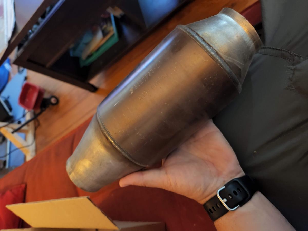

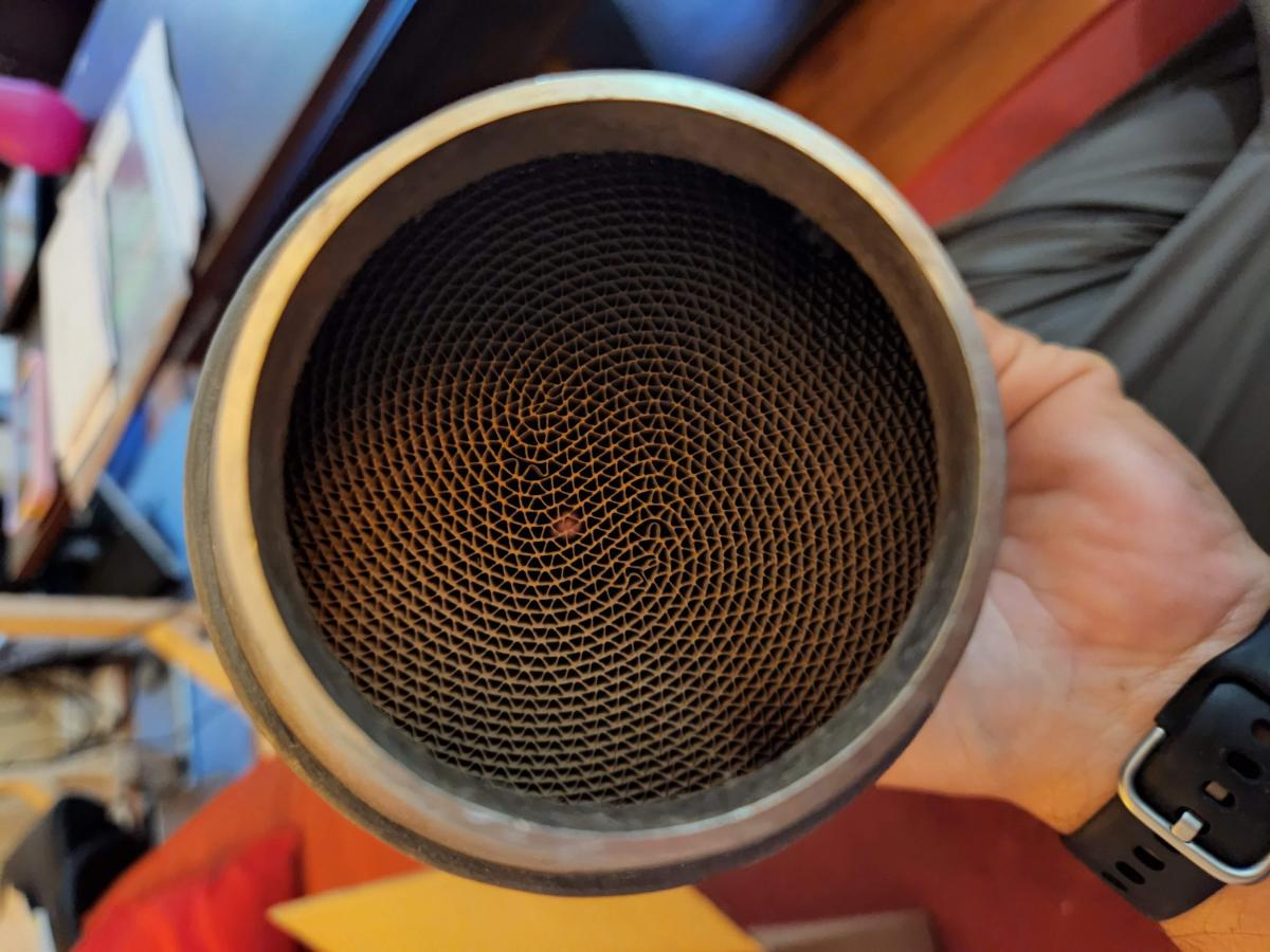

                              update on this thread. i bit the bullet and ordered the HJS 200 Cell Cats. they arrived today. dropping them along with both my euro section 1 and my US section 1 so the guy can decide which is the easier/better unit to cut/weld.
                              while this isn't the same as a supersprint catted section 1, it hopefully has a better fitment than some stories i've heard regarding the fabspeed unit.
