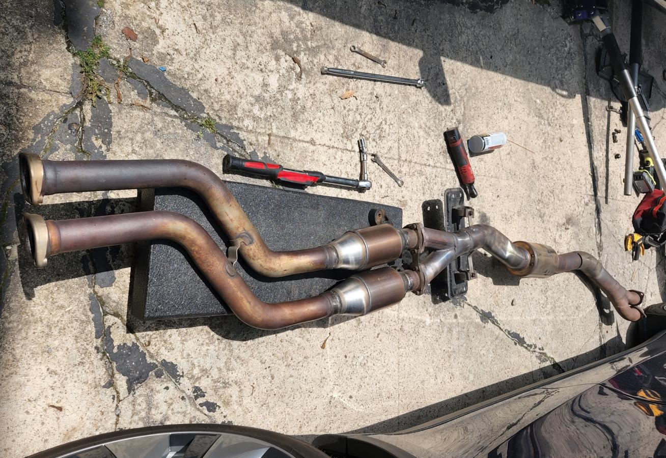

          Update: installed the Section 1 last weekend and drove it yesterday. Fitment was spot on. it was easier for me to section 1 and 2 and put it together outside of the care. i then used a jack, slid the section 1 in, fit section 2 to the muffler, then put the mid-brace on, and then torqued both ends.
          Breakin: for those that don't know, from what i understand there is a break-in cycle for new cats, which is very simple. turn on and idle for 5 minutes, then rev to 2500 RPM for 2 minutes. turn off and cool down and that's it.
          First drive: i don't know if the tone will change as i drive it more but after driving it, i'm a bit surprised. considering HJS claims upwards of 93-95% airflow, i expected the car to sound louder than my Euro Section 1. the result is the car sounds very timid. fwiw, i have Euro Headers, SS merged Section 2, SS Race Muffler. the drone is down to a minimum and the rasp is subtle but there...which i actually like.
          i don't have any video yet but will put something together when i can. overall i'm pretty satisfied. i have a pretty good flowing system with a sound that isn't as loud as thought it would be.

                        Great to see this DIY. As I am actually thinking about doing the same, would you share you impressions after some time? Was it worth it? What about smell? Power wise, do you feel any difference?
                        thank you for your thoughts
                        i feel it's completely worth it.
                        i was running catless and then put this on so performance wise, i feel like i didn't lost much/any from going back to cats.
                        considering these are HJS cats, they still have that performance aspect while doing their job with the smell/emissions.
                        absolutely zero smell.
