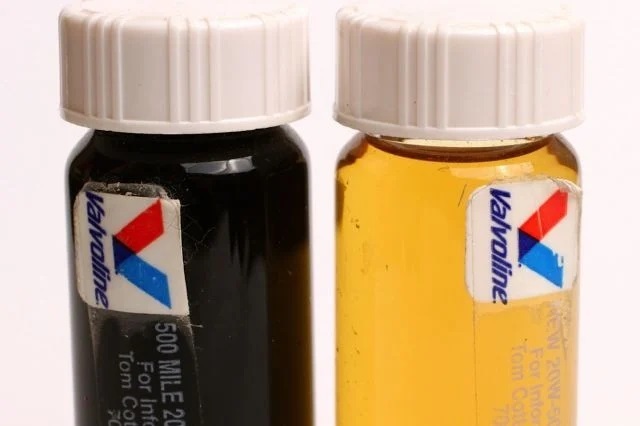

                    I get why people think this but it's incorrect and really needs to be mythbusted.
                    Race oils run the gamut from zero to healthy levels of detergency, depending on the application. AFAIK, the only engines that use no detergents are drag engines that get torn down after every pass and can't afford anything but the highest level of anti-wear performance. Everything else needs some amount of detergency. Combustion byproducts, oil breakdown, and fuel dilution would kill an engine that's run on non-detergent oil pretty quickly. The longer the race, the more the additive package looks like that of a street oil.
                    Look up any oil analysis on Motul 300V, or Mobil's race oils, or... basically any race oil that isn't explicitly marked as having no detergent. There's always some Ca and/or Mg in there. Less than in a long-drain street oil, but not zero.
                    Per this link, the pic below is from 500 miles in a NASCAR engine:
                    Click image for larger version  Name:	Race1-640x426.jpg Views:	0 Size:	43.2 KB ID:	56895
                    From that page:
                    The discoloration is the result of oxidation, which is caused by heat, soot and other combustion carbon byproducts that blow by the rings.
                    Again: does this oil have less detergency than a long-drain street oil? Almost definitely. But if it had none, the engine wouldn't finish the race. All that crap that's darkening the oil (because the detergents are holding it in suspension) would instead be collecting in the engine, polishing the cylinder bores, etc.
                      From that page:
                      Does this oil have less detergency than a long-drain street oil? Almost definitely. But if it had none, the engine wouldn't finish the race.
