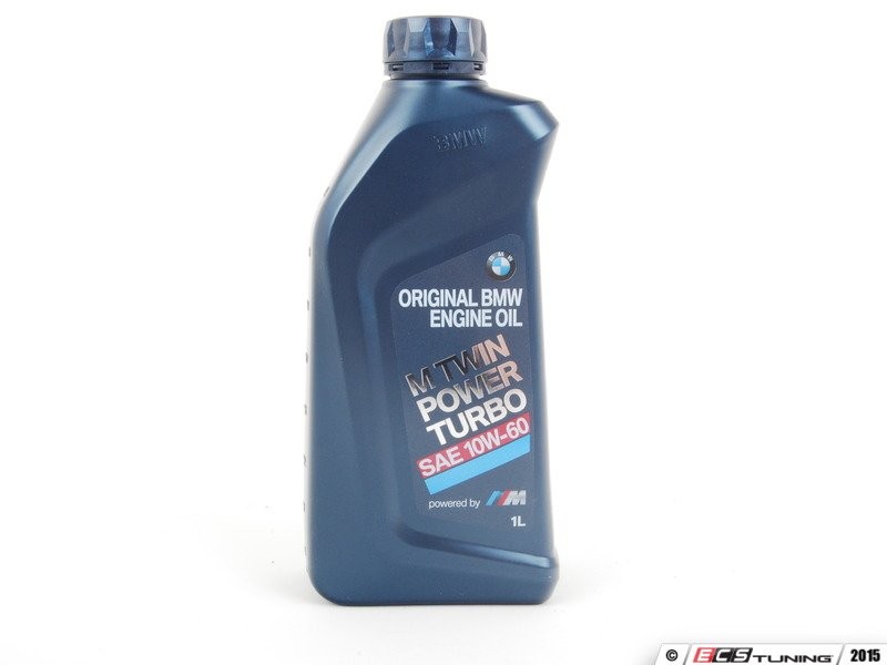

What oil?

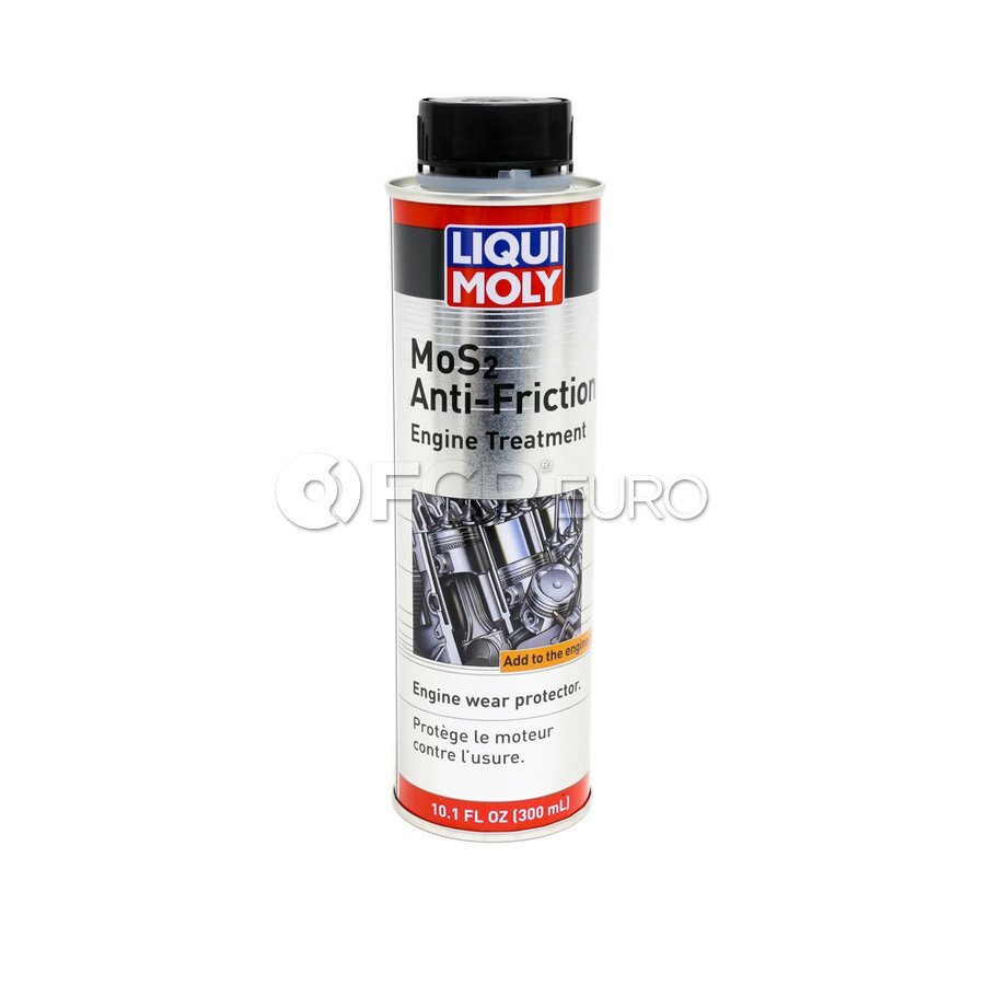

    I also add a can off this product from Liqui Moly. Purely from feel, the engine does feel a bit more “zingy-er”, but then again, it could be just going from oil that’s got 5k or 6k miles on it, to new lube in the crank case... 🤨 🤪

                    Only use castrol edge 10w60 or shell helix racing 10w60. The rest (liqui moly bmw 10w60 etc) do no have the additives needed. Ironically liqui moly does not have moly, Castrol does. Oh crap Tyler you got me to post about oil again
                    I'm with you on this. Motul does have some high ZDDP in it though. I'd use Motul. I wouldn't trust 5w-40 in my engine but I think people do successfully. I doubt that crap holds up under heavy load though... especially in Florida.I ordered some that Castrol edge for my new engine, which I kind of cringed over but people have been running it for years so 🙃
                    Liquimoly is just trash oil. My engine DID spin a bearing while using it. Ceratec probably doesn't work very well either. It's kinda stupid to design oil around additves but hey, people like adding additives for piece of mind when they can just buy good oil.

                      I have used OE BMW 10w60 for the last 5 years.
