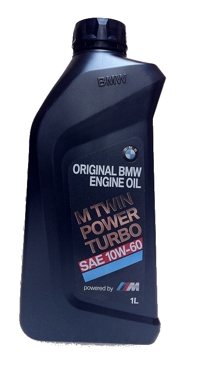

            BMW 10W-60 from FCP Euro with their lifetime warranty

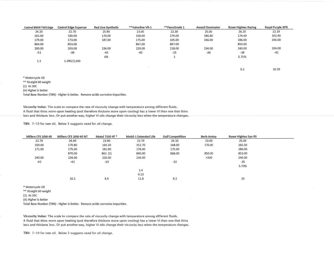

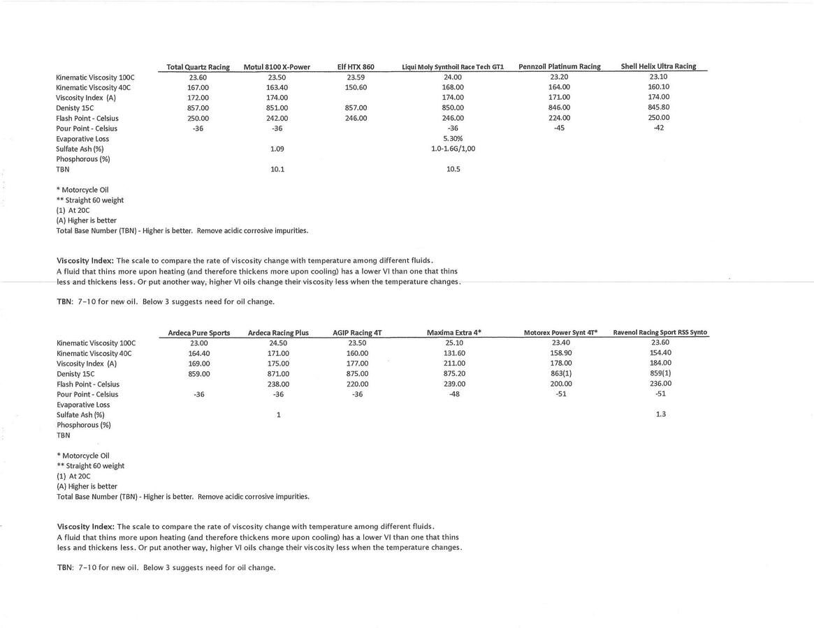

                          Here's a JPEG conversion of my 10W-60 synthetic oil Excel spreadsheet with manufacturer published test numbers for as many synthetic oils as I could track down. I hope this helps. I'm happy to e-mail the Excel sheet to anyone.

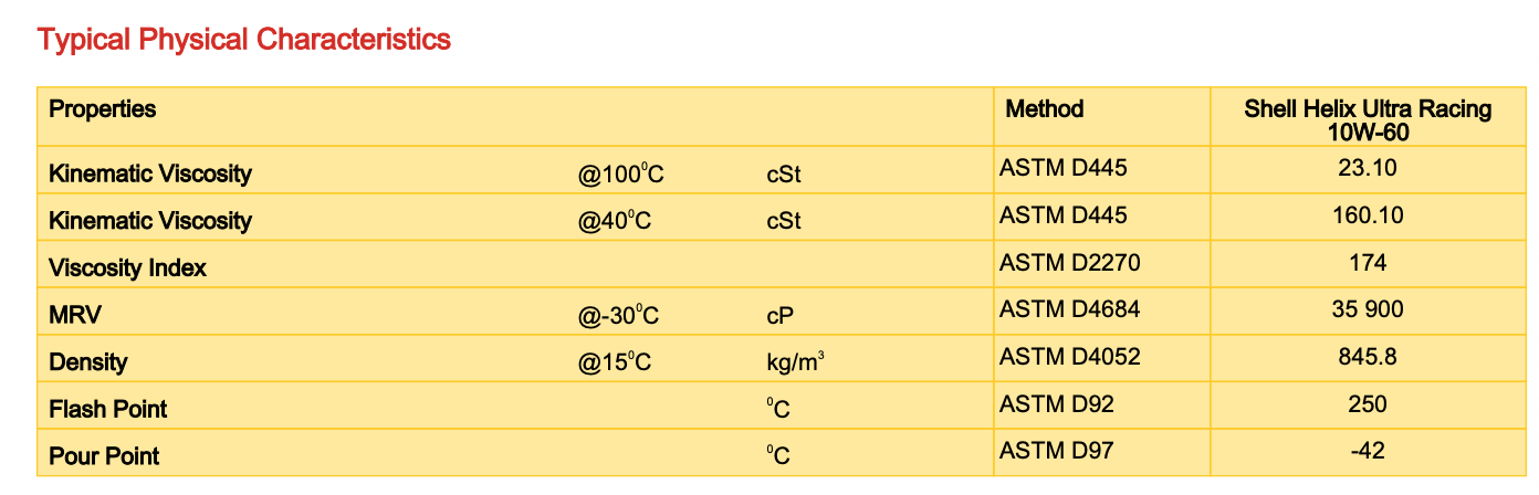

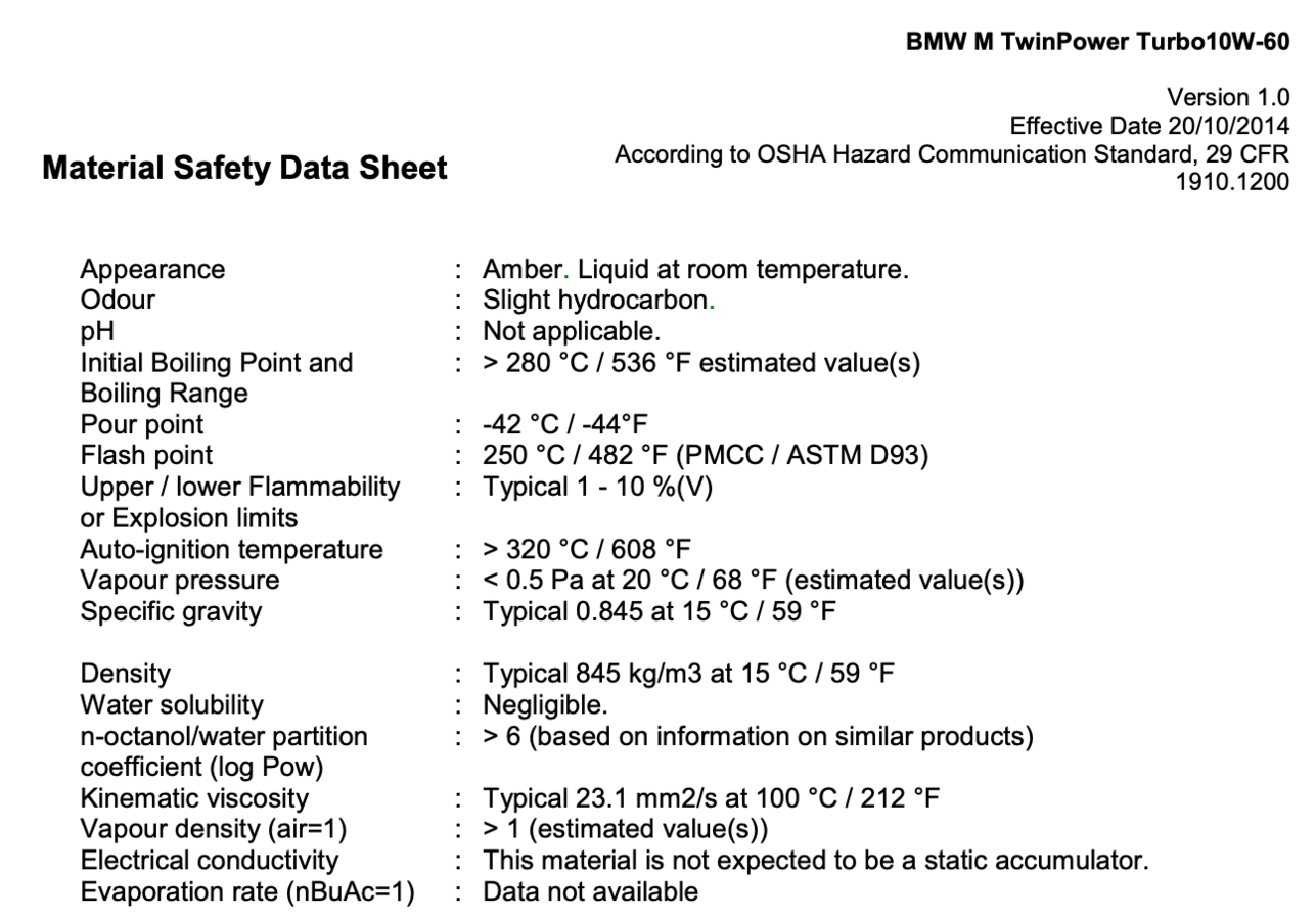

                              I think terra posted this before on M3F, but the MSDS of BMW TwinPower 10W60 and Shell Helix 10W60 is the same. Definitely looks like the same product.
