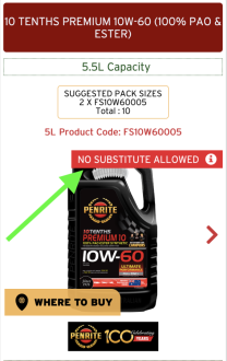

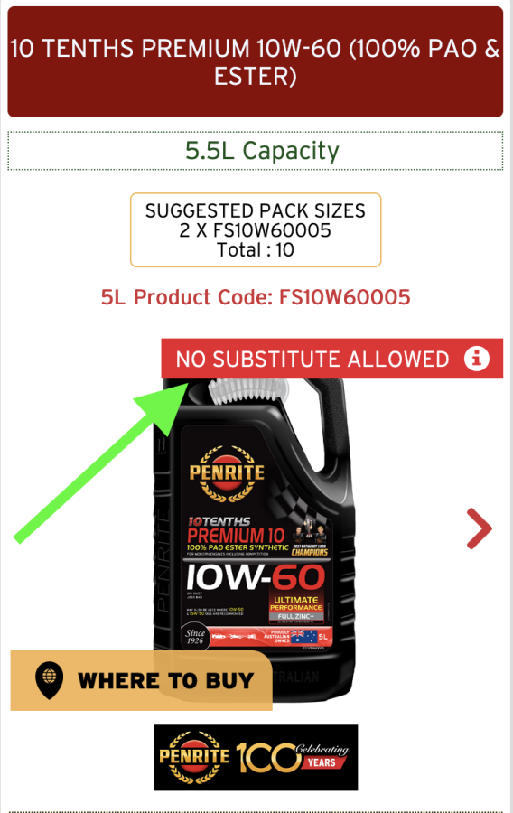

    If you're going to insist on rolling the dice and deviating from that, at least stick to what your favorite lube manufacturer recommends. AFAICT, the only engine oil Penrite recommends for this engine is their 10 Tenths Premium 10W-60, and they actually go out of their way to say it's the only one you should choose.
    Click image for larger version  Name:	Screenshot 2025-03-08 at 9.41.13 AM.png Views:	0 Size:	194.6 KB ID:	297138​
