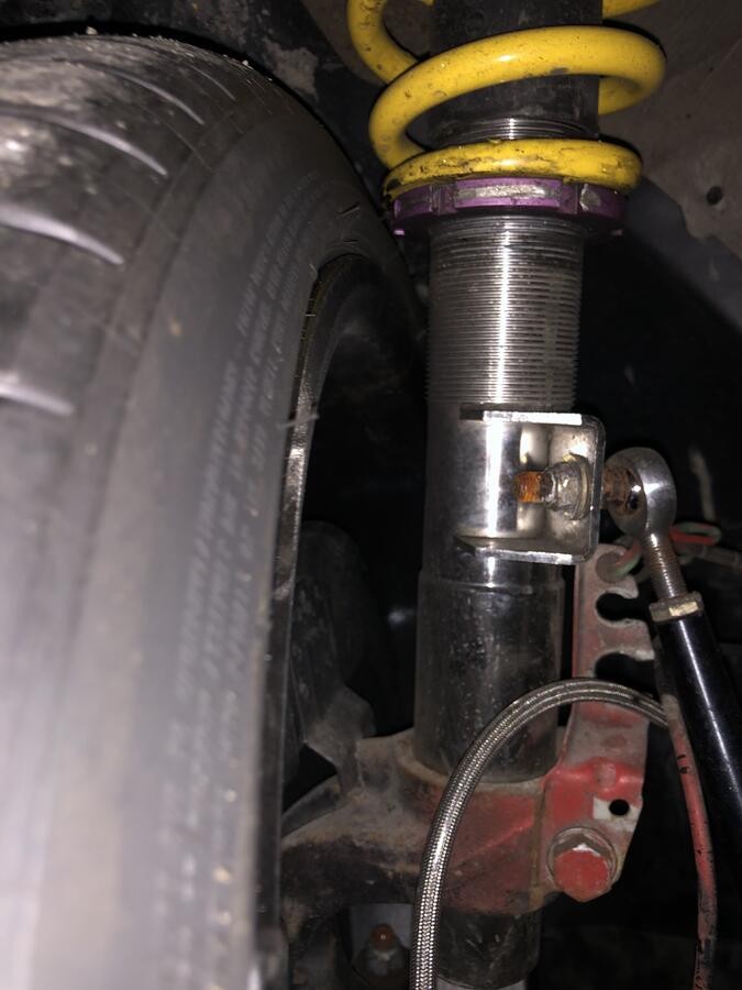

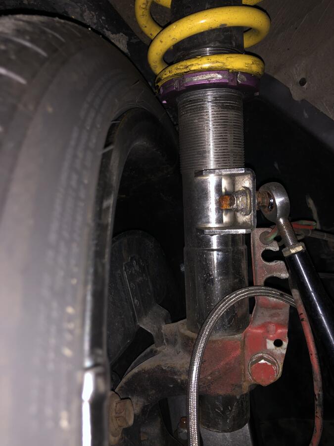

    I feel like this has been done before, but I can't find anything conclusive. My car has KW V2s and right now it has square ZCP/CSL rear wheels (19x9.5 et27). The front wheels have 245/35/19 tires (275/30/19 tires on the back, got the car like this). There is about a centimeter of clearance between the tire and the strut body.
    I'm getting custom-made 18x9.5 et28 wheels that are showing up soon -- will I have enough room with the extra-long KW spring to run 265/35/18? Will it rub on the spring?

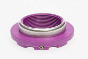

                    That looks like a different and more narrow spring perch than the usual KW perch.
                      Maybe a revised perch, the one in your pic is only a 1-2mm wider.

                          I had kw v2s before. 18x9.5 +28 with a 265 will fit as long as you're not too low and the tire doesn't run too wide.+35 offset will not fit unless you have a spacer.
