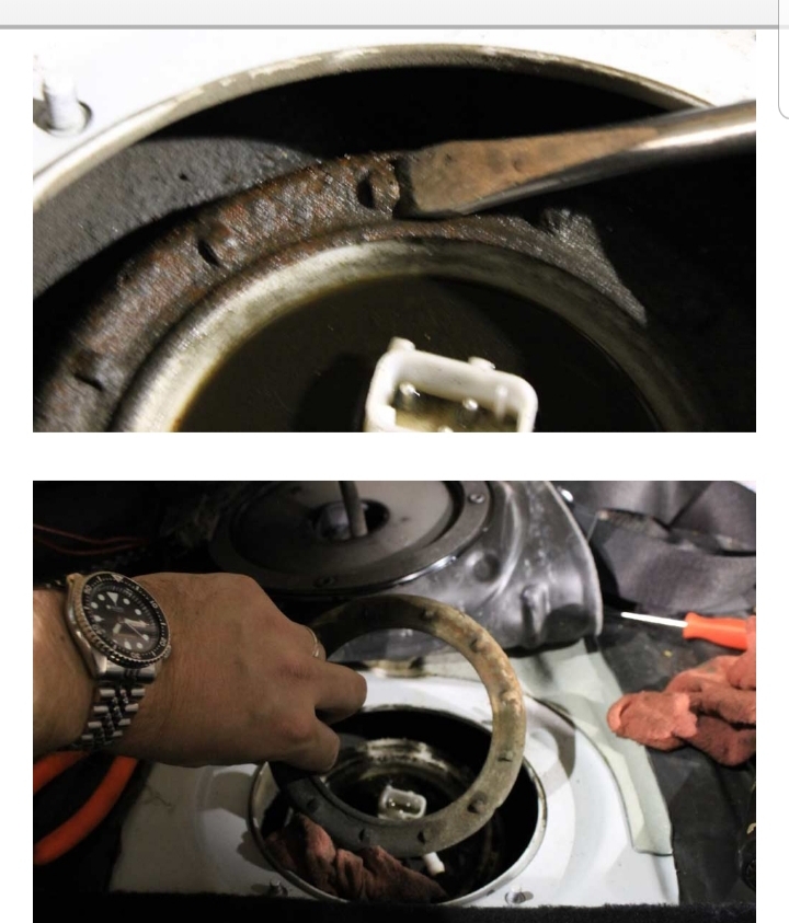

                          You don't need any special tool to remove the fuel pump. I'm assuming you are talking about the big screw on lock ring that holds it down. Use a screw driver and a hammer to tap around the circumference, it will come loose.
                          *not my pic
