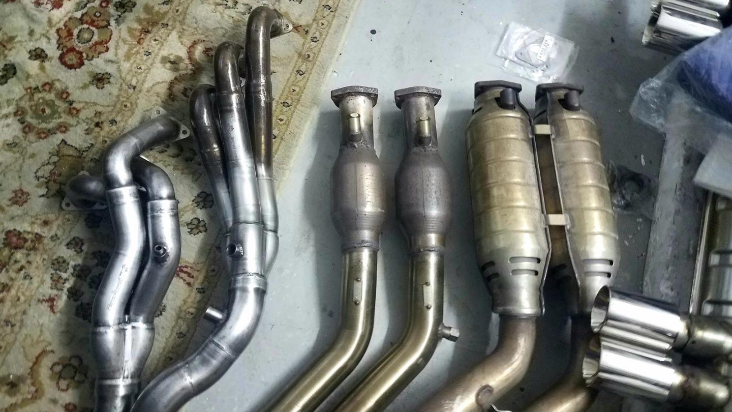

                            CPI did a group buy like 8 years ago with ss decat pipes and 2 x magnaflow 200 cell welded in for use with ssv1s. I had a set. They sucked. Smell isn't much better, flow isn't like hjs.
