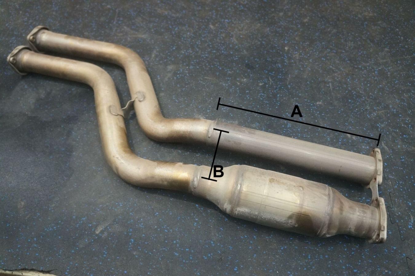

    Ok, cool. I’m game to try them. Does anyone have a spare Section 1 sitting around? I would be interested to know the length of the rear straight section—meaning, the portion after the kink and before the flange.
    The little resonators above should fit without issue, but I would like to confirm before undertaking the project.
    if this works, it will make for an easy way to replicate the Euro200R based on currently available parts. Maybe I can have my exhaust guy make up a bunch of them if there are enough interested members.
      Thanks for sharing the resonator info. I’ve been interested something that could be added to my SS catted section 1 to help tame some rasp so I’ll be looking at the fit potential too.
        More resonators = more boring exhaust note fyi. But perhaps some want that 🤷‍♂️

          A: 13.5"
          B (distance between centers of pipes): 5"
          Hope that helps

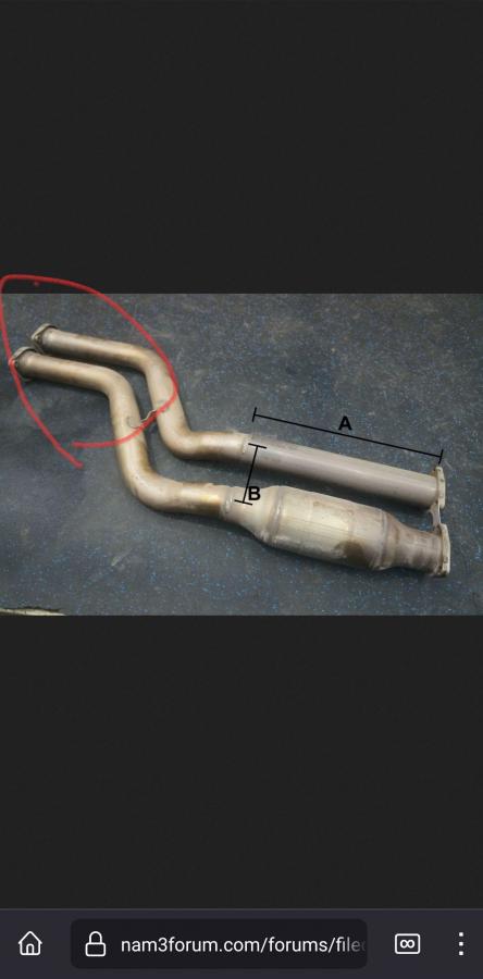

            I think he meant this part

              Thank you! I need to check the location of my cats, but I believe they are in the location that you measured. Would you mind measuring the rear portion of your Section 1 (after the kink) so we have that too?
              EthanolTurbo is correct — I was initially focused on the rear portion as that is where I believe the squatty resonators will go.

                Oh my bad. Read "rear straight section" and assumed it was that part. Would make sense that the necessary measurements are for the other bit, just didn't give it too much thought.
                I'll grab those measurements tomorrow
                  Max, I think you're looking at sect 1 backwards. The straight sections are immediately after the headers. Cats in sect 1, like euro or ebay piece or SS, are always in the latter portion before sect 2 (makes more power farther back). Just like the single resonator is on u.s. cars.
                  CPI even put both cats and resonators together, despite the lack of real estate (to hold both), in that latter portion, if memory serves.
                  There's also the matter of clearance from body. Earlier portion has less room. The pipes are also too close together there (versus the "B" that Heinz measured)

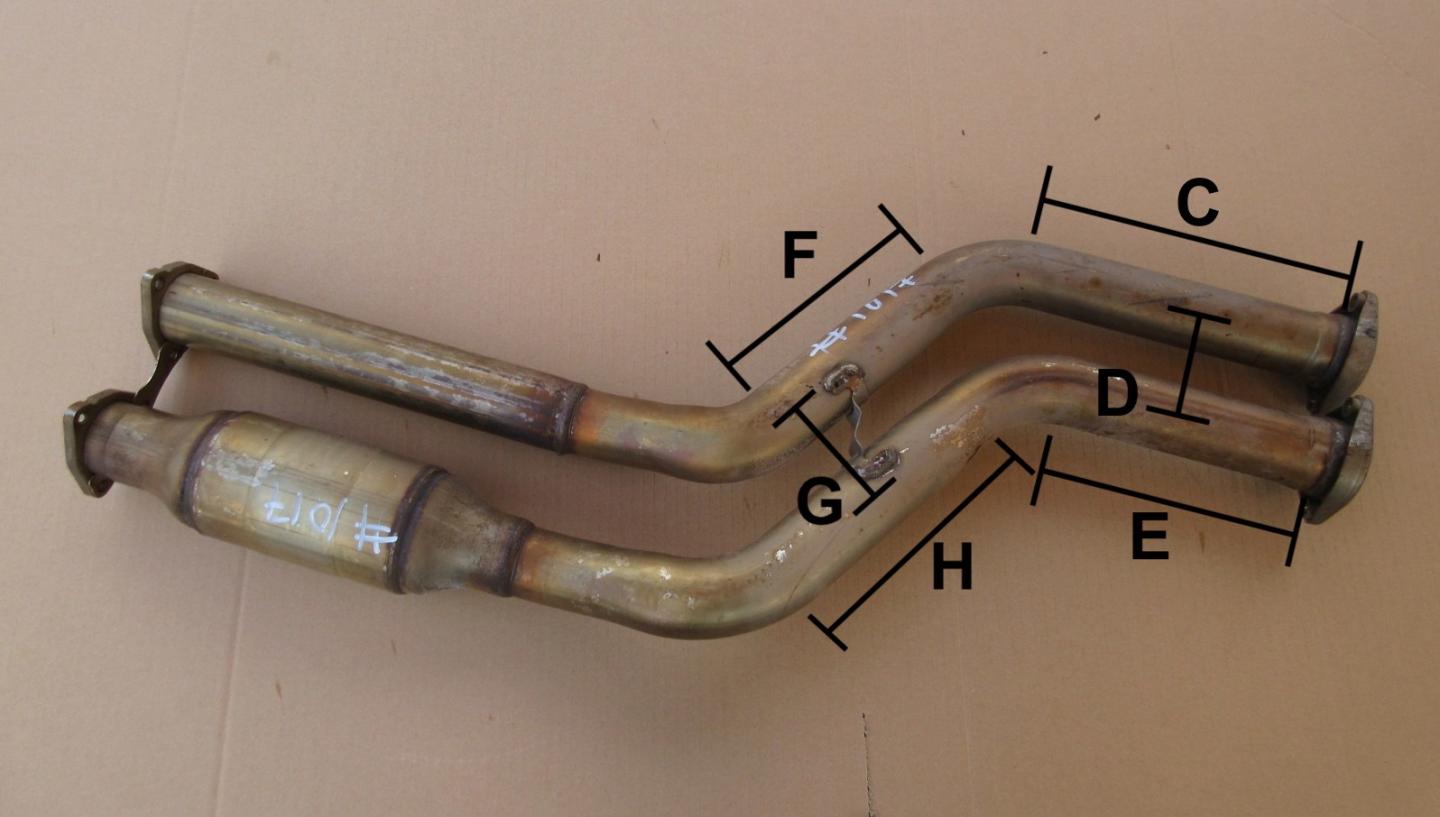

                    Click image for larger version  Name:	pk007254-2003-bmw-m3-e46-1017-oem-exhaust-mid-pipe-section-1-front-18107832909.jpg Views:	0 Size:	82.8 KB ID:	205318
                    C: 10.5"
                    D (distance between centers): 4"
                    E: 8"
                    F: 7"
                    G (distance between centers): 4"
                    H: 8"
                    Those resonators you linked are 6.5" long and 4" in diameter, so should just barely work if you put them in sections C and E.

                        Thanks so much for this. I think I can sneak one--perhaps two--resonators into the C/E section, provided the body work and heat shields allow it. Then again, I am finding that the rasp goes away as everything heats up and that rasp increased with the addition of an Evolve airbox. I might just swap to a euro section 1 if/when one of those pops up. The beefier cats should cut down on everything and yield an improvement across the board.
