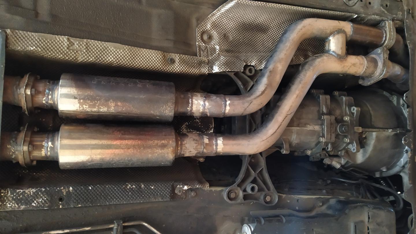

      Thanks for reply Tyler, Seems like people already did tests on crossovers here, so i guess im wrong and my crossover location is bad (see pic), So ill take your advice and move my H pipe to factory location and hopefully ill get my power back.
        #48
        No problem. You could put it right before those resonators like CPI (bought by bimmerworld) used to do on their sect 1s, that seemed to work fine (dyno-wise).
        I'd just put the stock sect 2 back. It's actually 60mm overall (it starts out at like 58mm where it meets sect 1iirc, but opens up, sometimes into a square shape).

          Now im scared if i put it before resonators it wont be as efficient as in section 2.
          I didn't want to to touch section 2 since its Meisterchaft/Eisenmann piece, thats why i put H pipe in section 1 in first place but turns out it was bad idea 😅
          Btw i know that my section 1 is ugly af but it's only test piece atm, once the results will be met, ill take it to exhaust shop that will use TIG and stainless steel to weld up beautiful version of it 🙂
