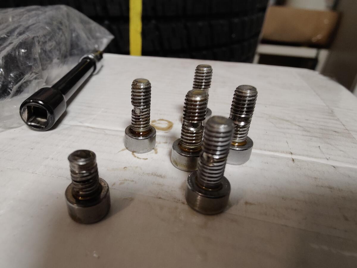

    So my friend's 06 M3 had its cam bolts replaced with the updated torx head BMW bolts which proceeded to snap just like the previous bolts in 12k miles. Is there a possibility that the previously snapped bolts damaged the threads and caused this to occur once again? Has anyone experienced something like this or recommends a different type of bolt?

            I'm interested of seeing the cam sleeve 6 holes, and how bad they had been distorted after hammering on the bolts to cut a notch.

              Red Loctite was used, and it was torqued properly according to my knowledge. Can even slight over-torque cause this?
                We did not use a hammer to remove the previously snapped bolts, just used a pick and spun them out. We wouldn't have even caught this if we weren't swapping out his cams.

                  Not as a tool, but the hammering effect when there was plays between the sleeve and the loose bolts.
