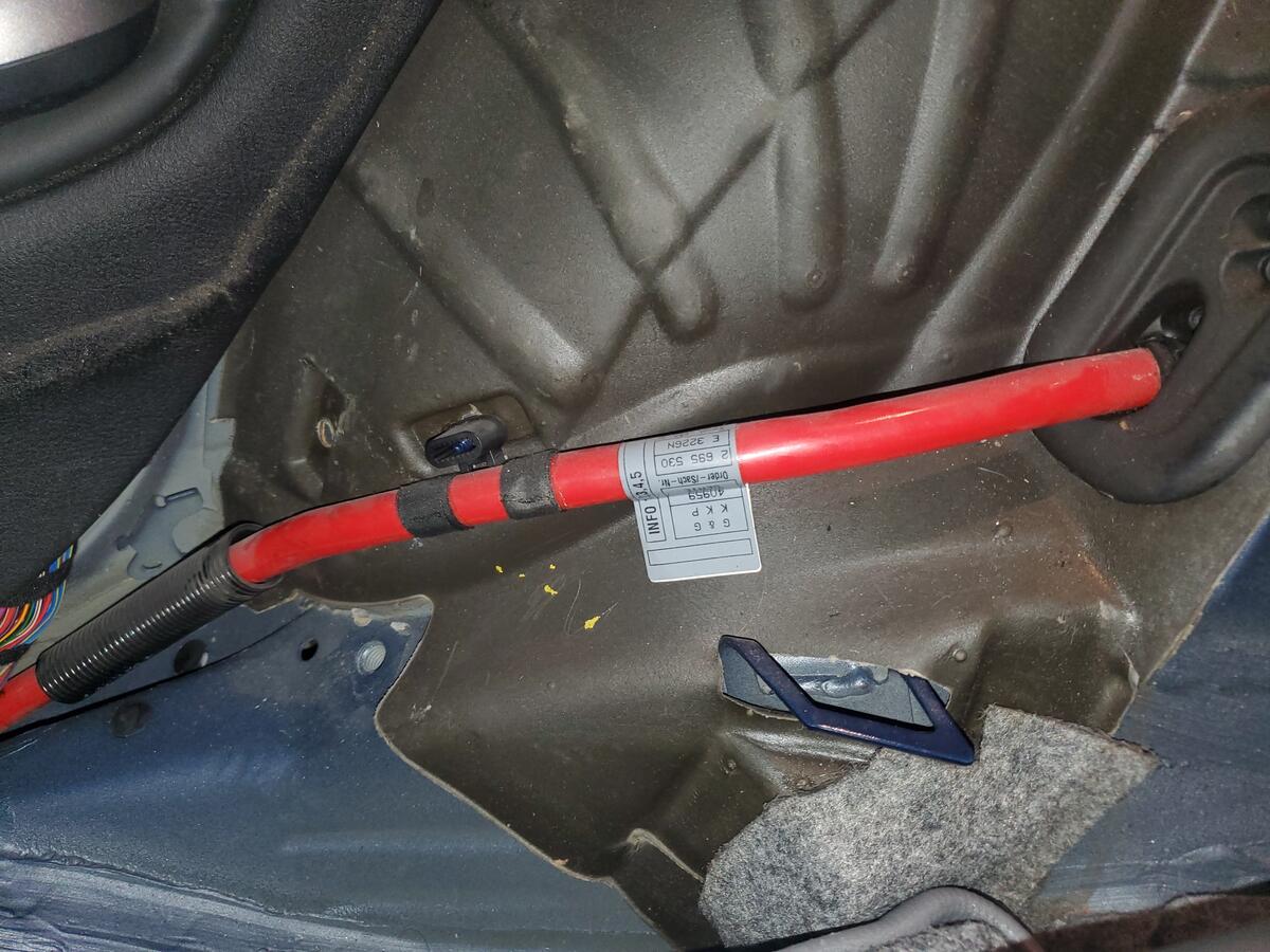

    Okay, battery cable is fine, so that's good.

    Drove the car some more and the noise is now showing up at lower speeds too. Also realized it's directly correlated with how much rasp is being produced by the engine, so I'm leaning towards the "something rattling around" theory. Will check out the underside of the car later tonight.
      I'd check the parking brake cable isn't coming into contact with the axle. Sounds like it could be a wheel bearing, hub, axle or diff bearing issue. I'd look at the axle and make sure there is no evidence of something making contact. Then I would jack up the rear and spin the tires.
        Quick update on this.
        The airbag light came on the other day so I checked for codes with INPA. There was one code stored for some fault with the BST. Turns out that the BST connector is a bit broken and was only plugged in halfway. Plugged it in entirely (I'll swap it out soon), cleared codes and the light went away.
        Next time I drove the car, the noise was gone! I was unable to reproduce it no matter how much I tried. Kinda sketch that it might have been related to the BST, tbh.
        However, I hadn't driven the car since I took the rear interior apart to check on the battery cable, so it's totally possible that there was something loose back there and I accidentally fixed it when reinstalling everything. Don't think I'll know for sure, but the noise is definitely gone now.
