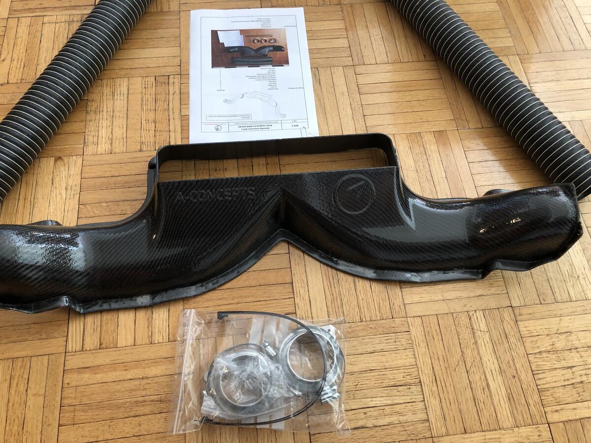

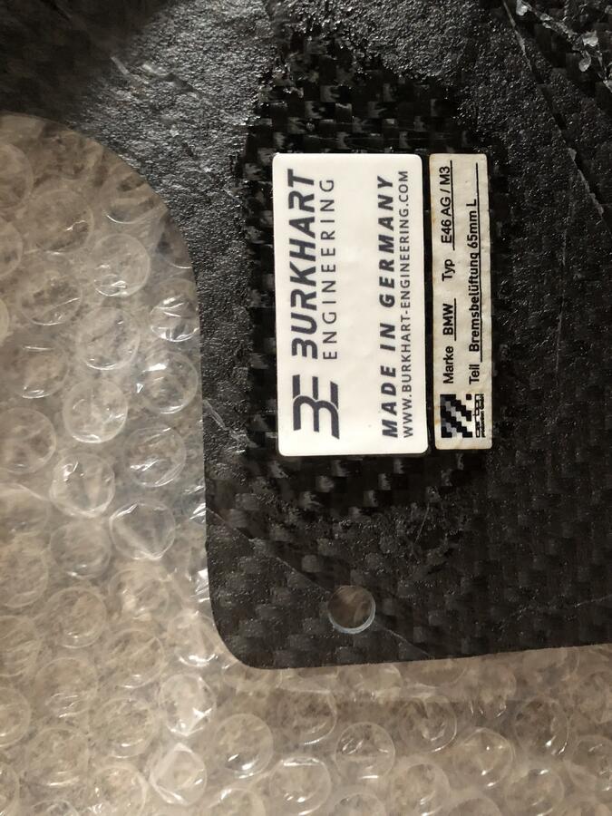

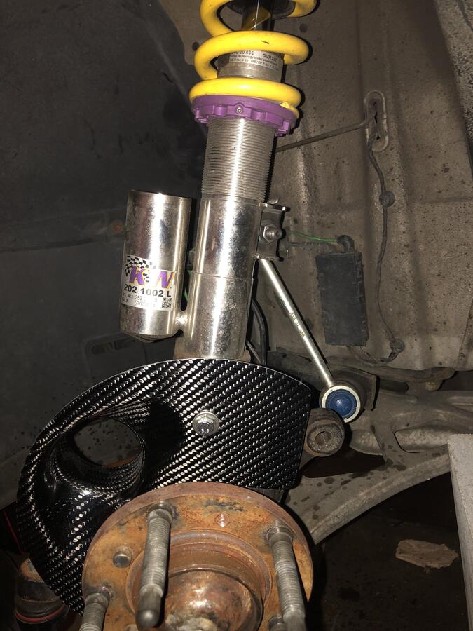

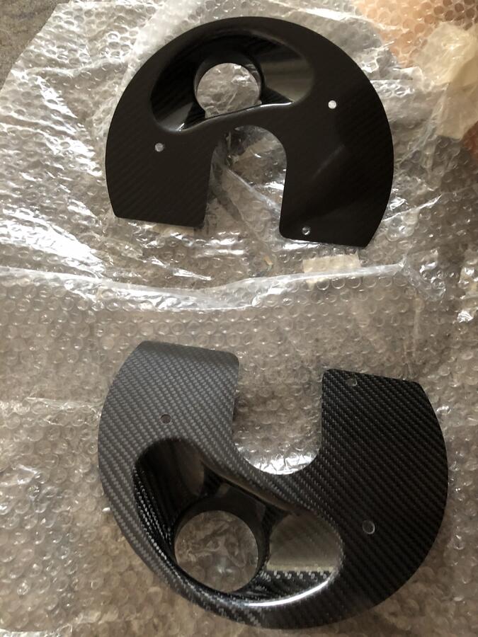

              I’m using burkhart carbon backing plates. I ended up installing them at the same time as the 996 and ecs rotor. The setup was great a Watkins Glen. I was running caliper temps way lower than my brothers (one had stoptech trophy and the other ap racing). I never had brake fade on track. But I also manage my driving to try to keep them cool.

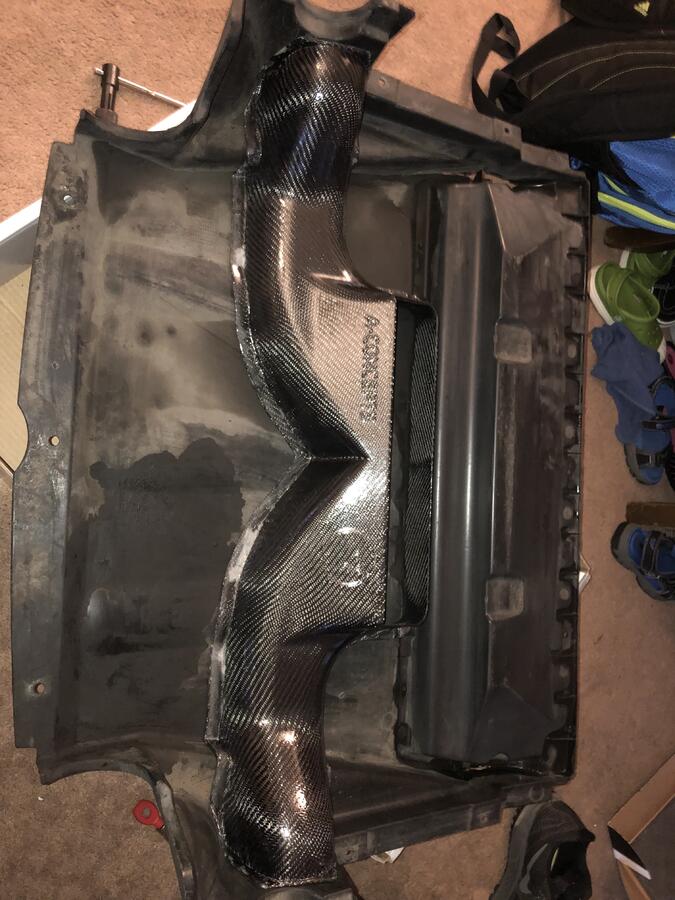

              I really need to create a build thread. Just remembered a cool brake ducting setup that I got to work with my csl bumper. Added some pics on that😊
                #52
                I reused the original dust shield and enlarged the hole that already exists right in front of the bearing. Trimmed off pieces of the dust shield that sit super close to the inner rotor surface so it didn't trap heat. I also reused the stock inlet and didn't bring the hose inlet to the front of the bumper (because eventuri). I went the cheaper diy route. Pics of pass side below.
                I know the stock shied doesn't seal perfectly, but I did some testing with a leaf blower and on track. Without cooling I lost 3mm of pad after an hpde day, with cooling a new set of pads wore only 1mm.

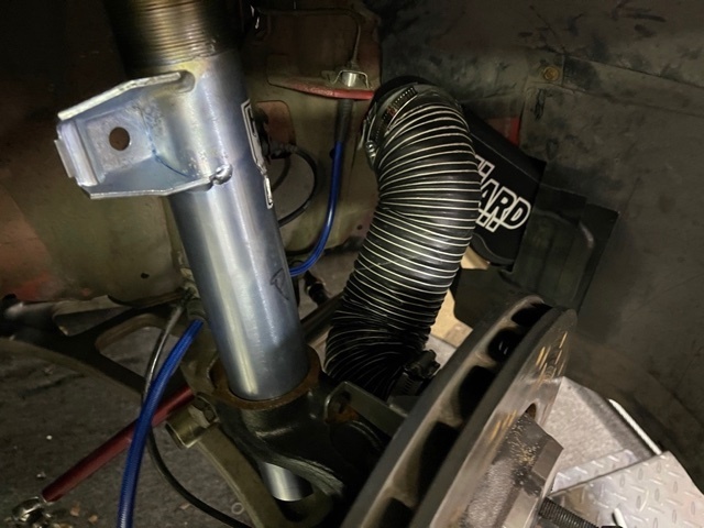

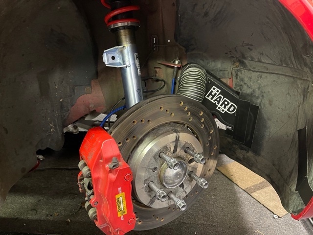

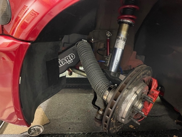

                  I'm running the Hard backing plates, low profile transfer tubes, and ducts. I like that I can get full steering lock without rubbing and that it looks unexceptional/stockish from outside.
