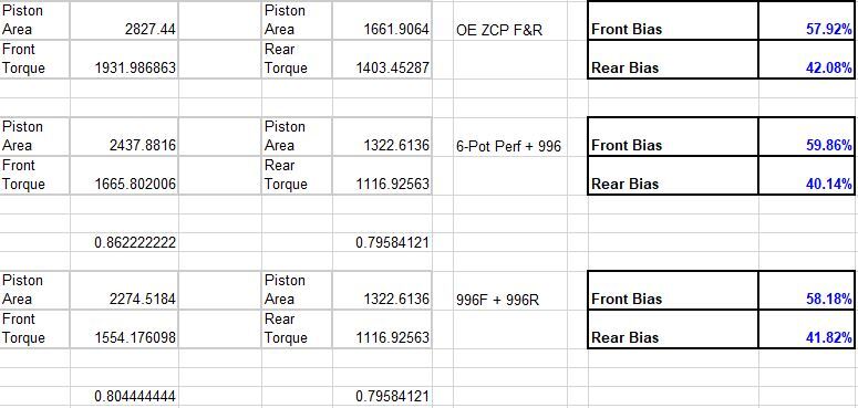

                How do you guys feel about how the 996 calipers affect the brake bias vs stock?
                true betold, 996 option actually provides less braking power, but they improve feel and modulation, if done front and right balance is basically unaffected from a bias point of view.
                I went with BMW 6 pote E9x/E8x Performance calipers and rear 996, but again, I do have 14% and 20% less braking power front and rear respectively from the OE ZCP / CSL setup
                  #38
                  Click image for larger version  Name:	CompChart.JPG Views:	0 Size:	46.6 KB ID:	139943
                  You can see that break torque for Porsche setup and my setup is less from the base ZCP setup that my car had (Z4M)
                  I am very happy with feel and modulation, makes you believe you have better brakes, but the reality is that the base system is more powerful. I can still trigger the ABS on dry tarmac, but for a track junkie with track tires, etc, I bet the stock brakes do better objectively, even when we don't like how they feel.

                      You have to apply more pedal because the caliper piston area is smaller in total than the stock (at least ZCP) setup. That means without larger MC pistons, the pedal has to travel further down to apply the same torque at the pad and rotor. It doesn’t mean at all that there is less total brake torque available, just that the pedal has to travel more to get that torque (up to the limit of pedal on the floor, but neither setup gets even close to that condition)
                      edit: might have some things backward but the point stands that there is plenty of pressure available from the stock pedal / MC to provide the same braking force / torque with both setups without having the pedal on the floor
                        #41
                        Yes, but pedal travel is limited, so at max pedal travel, with all else equal, the stock brake calipers outpower the 996's.
                        I am not debating or arguing, just sharing data for people to make informed decisions and prioritize what they want based on their needs and objectives.
                          #42
                          Yep totally true I suppose. It just doesn't really matter because neither setup will get to max pedal travel even standing on the brakes. The system will max out at some point (for non-hulks at least) before the pedal hits the floor depending on compressibility of the pad.
                          The 996 setup certainly has a softer pedal but IMO the stock ZCP brakes were too hard and difficult to modulate. Totally personal preference though!
