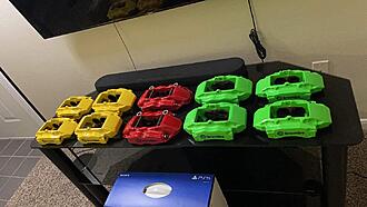

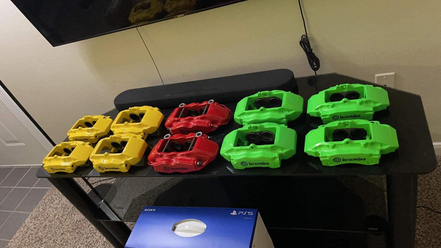

                            Someone rang?
                            I have 996’s fresh from coating for sale, yellow set is pending sale tomorrow, buyer has a few questions.
