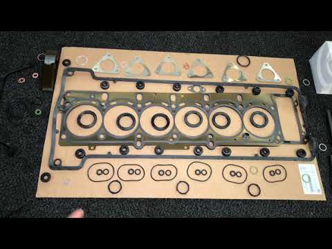

              The engine bay is your engine stand lol. Plenty of HGs replaced in the UK with the engine in the car:
