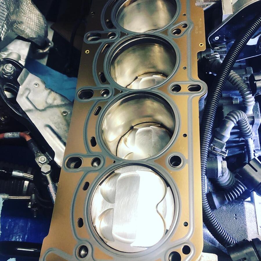

              Looks like my and everyone else's suspicions have been proven accurate, blown headgasket between cylinder 2 and 3.
              Upon pulling the head off, take a look at the block and the head and let me know your thoughts? Doesn't look like any damage on the head at all, do you all suggest I still take it to get decked?
              Sent from my Pixel 5 using Tapatalk

                        #41
                        Head has pitting and needs flycut.
                        Block: clean up all gasket residual really good, then use Sharpie color the whole cylinder divider top, then gently sliding a flat granite on the surface to see if the Sharpie is rubbed off evenly.

                            UPDATE:
                            The photo looks like the cylinder head is in fact damaged. Hard to tell how deep but your fingernail easily catches that black spot, no?
                              #44
                              Hey. Glad to see we diagnosed correctly. You will want to take the head into your machine shop at the bare minimum. They should check it out and advise you for free. I would 100% get it check out by a professional as there isn’t much we can tell you from photos alone
