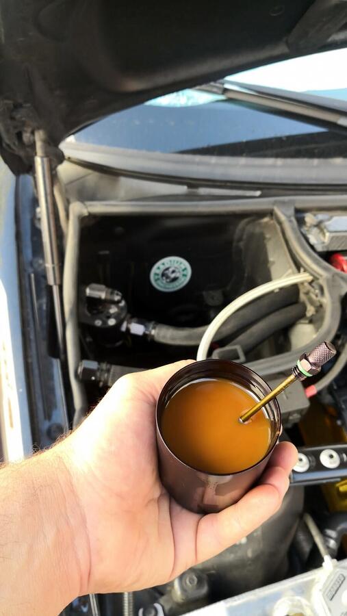

                              Same catch can here, mine catch a lot, i check it when i remember that i have it, lol always pick up a bunch of coffee.
                              Last time a few month a go:
