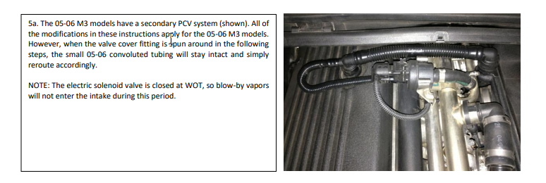

          Sorry to bump an old thread, but has anyone installed this on an 05 or 06 M3? I'm dumb and am very much stuck trying to figure out how to route the secondary PCV system using Radium's install instructions (step 5a):
          Click image for larger version  Name:	radium.png Views:	0 Size:	172.4 KB ID:	307251
          What am I missing here?!
            The verbiage is pretty self explanatory. It refers to the valve cover fitting that has the smaller tube going to the solenoid. If you have a later car, you can either reroute the smaller tubing, depending on how old and brittle it is, or cut the smaller hose off and retain the fitting to the solenoid. Use an appropriate rubber tube replacement, then wash your hands and have a cold one.

              I ended up figuring it out. My issue was not realizing just how far I could spin the smaller tubing without it breaking/cracking in order to get the fitting to point the other direction towards the catch can. I can't post photos from my work computer (Flickr is blocked), so I'll get around to that later.
