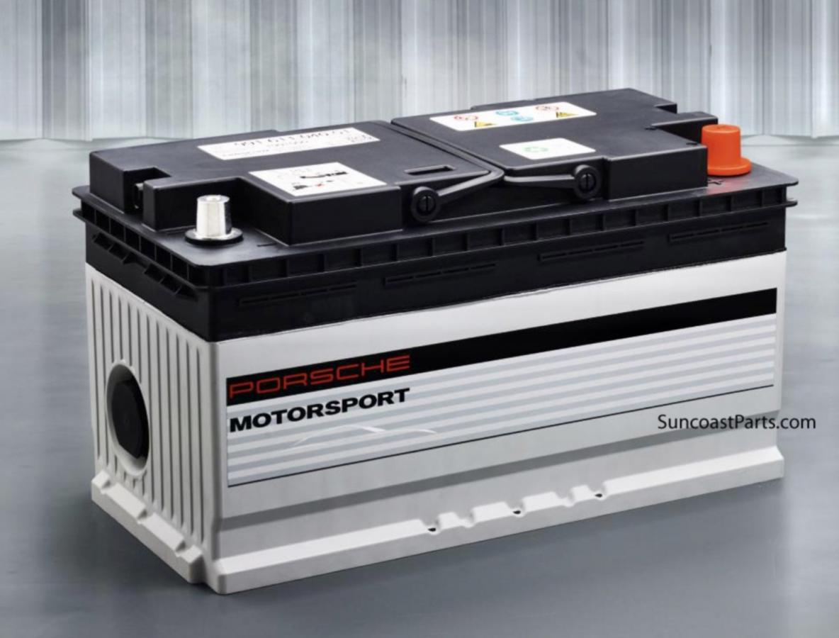

              If you think a G is nuts, how about 5 Gs for a car battery for a 991 GT3?
