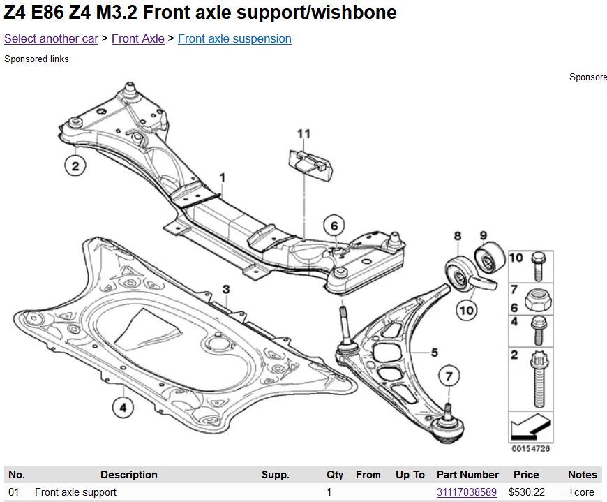

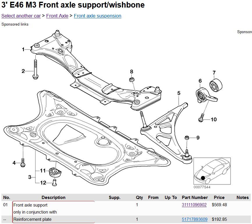

    terra pointed out the other day that the Z4M front subframe is a different PN than the M3 part, despite bolting onto same location and looking similar. He speculated that perhaps it was to correct the roll centers change from the lower ride height on the Z4M.
    Has anyone ever measured, to see what the actual difference in that part is?
    Click image for larger version  Name:	m3.JPG Views:	3 Size:	100.8 KB ID:	141604 Click image for larger version  Name:	Z4M.JPG Views:	3 Size:	82.3 KB ID:	141605

            Edit: Looks like the N52 E85/6 Z4 uses the same front subframe as the E46 M3. According to TIS, both the N52 and S54 Z4s have the same ride height. Roll center correction theory is looking less likely to me, unless TIS is wrong/missing information. Maybe just an updated part number?
            Double edit: For the Z4s, TIS lists both the regular ride height and the "Low-slung sports suspension" ride height. The sports suspension is ~15 mm lower than the regular one.
            I don't know too much about the Zs, so I assumed the sports suspension was some sort of package you could get on any car. But it's possible that the sports suspension is just the M car. If that's the case, then the roll center correction theory is back on the table.
