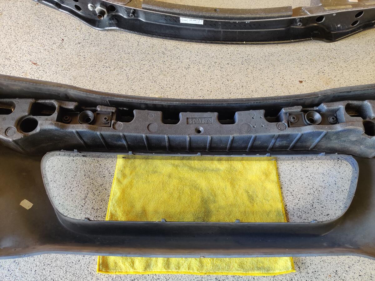

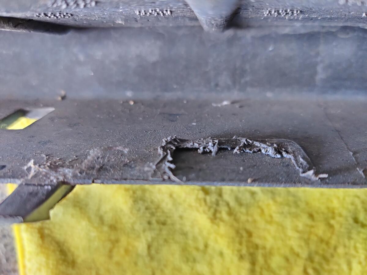

      For what it's worth and given this is a problem I will have to solve, here are pics I took of my US Spec bumper (Front bumper part #: 51117894990). The bumper is original to the car.
      The tabs appear to have been shaved off from the factory. I'm not sure how much of the tabs you removed, but these were shaved off completely. All 4 of them look like this.

          Looks like the Euro bumper also isn't supposed to have the tabs based on ECS' pics. I guess whoever manufactures these for BMW forgot to shave themoff.
            I just checked my 2002+ euro front bumper that I received from ECS a few weeks ago, it also have those tabs.
              My “euro” bumper was direct from BMW this month and it had the tabs. My shop just installed last week and I mentioned the “tabs” and how it was said to cause fitment issues. He said they left the tabs. The tabs didn’t interfere on my kevlar bumper, the tabs just slide under the Kevlar bumper carrier not impeding fitment.
              I examined it and it has no fitment issues.

                Glad I stumbled upon this thread, getting ready to install my Euro bumper now. It also has the Tabs. For 06/kevlar bumper carrier.
                Checked photos of my original U.S. spec bumper - it does not have tabs.
                Consensus is just to leave them, yes?
                  I had to cut them off in order to get the bumper to sit properly. I suggest trying it as is and if it doesn’t fit right then consider cutting them off.
                    ^Okay, got it thank you. Will report back
                      Yeah mine fit with them intact. But you don’t need them for the Kevlar carrier afaik. So if you’re going to cut them, it would be best before you paint. If you’re able to test fit before painting that would be my suggestion to be safe.
                        A little late but I'll add this for future reference. I just replaced my bumper with a Euro. Those tabs are for push pins that go into the aluminum carrier. You can cut them off for the Kevlar carrier since they're not used. I didn't realize they were there when I removed my original bumper and tore through the holes.

                                Let me save anyone reading this some time: If you bought a new Euro bumper cover, cut the tabs off if you have a carbon bumper/carrier. I can't confirm what you should do if you have a aluminum carrier, but suspect you do not cut the tabs off.
                                I tried to keep the tabs in place like the OP just to see if maybe I could make it fit, despite others saying they couldn't fit the bumper until cutting the tabs. No dice. I cut a little bit off the tabs. Better, but still no dice. Finally cut the same amount (the whole tabs!) as pictured above in my factory bumper cover and it fit perfectly.
