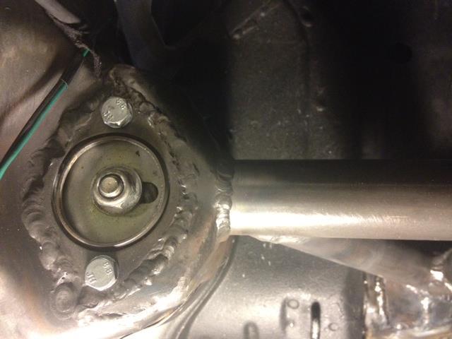

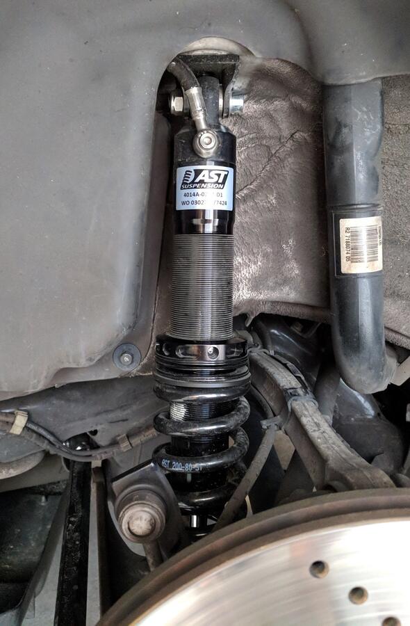

    Looking to convert to true coilovers in the rear, any insight on rear shock tower reinforcement that is recommended/necessary would be greatly appreciated. (I'm specifically targeting welded in kits, I am not yet ready for a cage which I understand is the ideal solution.)
    Edit: I'm referring to a coilover setup with an upper clevis mount where the spring and shock are no longer separated like the OEM configuration.
    Example:

          I hesitate to say basic shock reinforcement plates would be sufficient. Us regular guys run reinforcement plates, but I feel like you'd want some further reinforcement beyond that for true rear coilover, and then tie them together (strut bar) and tie them to subframe mount points if possible ala CMP.
              Ah lol completely missed that detail. Yeah those plates wouldn't do anything with a coilover conversion.
              But yeah sounds like much more reinforcement that the typical shock tower plates would be needed for a true coilover setup.
