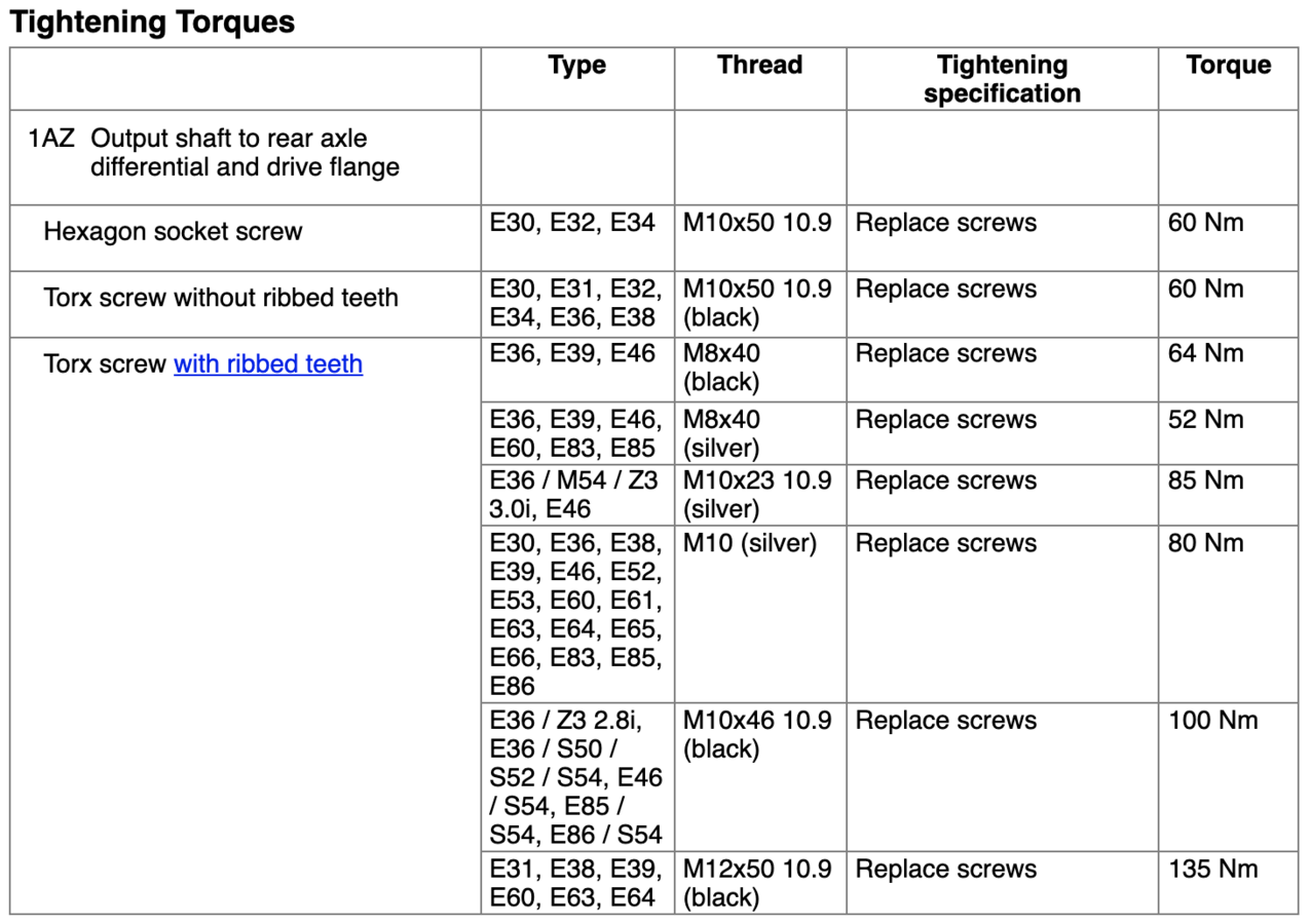

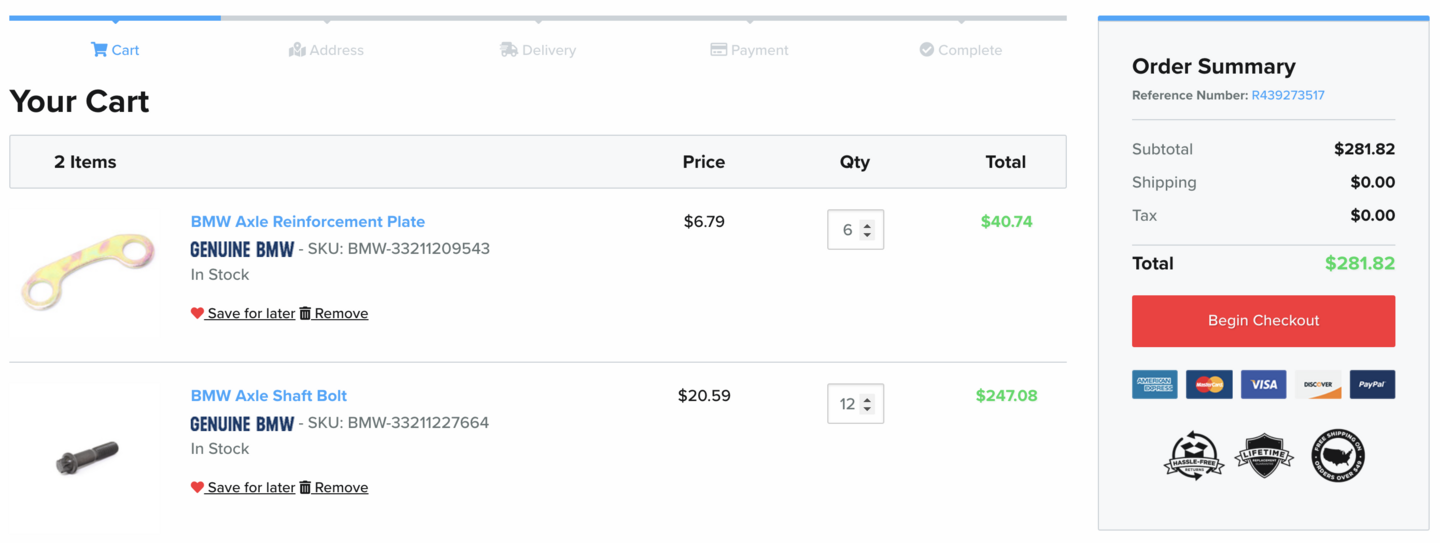

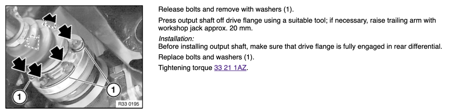

          I recently learned that TIS calls for the replacement of both the washers and bolts on the output shafts of the diff.

          I'll let you decide if you want to spend $300 replacing those though:

          I've reused mine a couple times (as have others) and they've been fine. But, the plural of anecdote is not evidence.
            When I installed a new driveshaft I saw that as well and replaced them since I could tell it wasn't the first time they had been off. However, they were no where near that expensive, dang.
              Ouch, I think I will re-use mine or find maybe try and find a suitable alternative.
