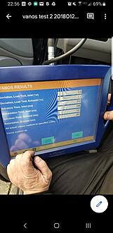

                    is there a way to test the vanos in inpa or is there another program?
                    INPA can not perform the VANOS test, you have to use DIS, which you can download on your computer (but it's a bear to get working).
                    Few easier ways to do the test - find an enthusiast near you who has DIS on their laptop and borrow, or ask a local BMW shop if they have Autologic and if they can run it for you (test itself takes only a minute or two, and they plug in via OBD2 port).
                    Pic of autologic:
                    Click image for larger version  Name:	Screenshot_20200421-225643_Drive.jpg Views:	0 Size:	47.3 KB ID:	15413
